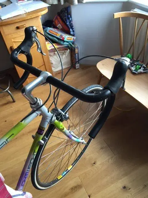

Thanks for the comments. Took a bit of time but happy with the results. Ended up with a slight cross but I think they'll be tight if I go any shorter and looks OK like this I think.
