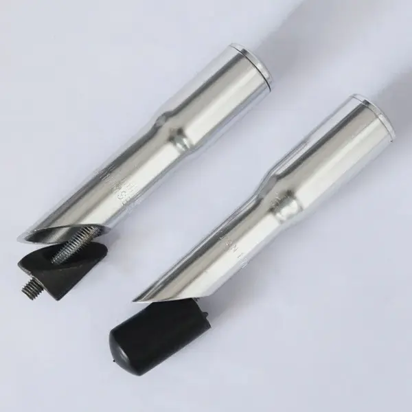

I'd be wary of extenders that use wedges, ideally they are 360° expanders to get better contact with the steerer.

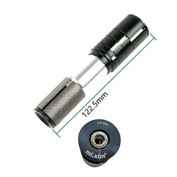

This is one of the better ones that I've seen: https://www.ebay.co.uk/itm/303954023499, in that it has a deep knurled expanding section to grip the steerer, and also (I think) compresses the headset correctly via that flanged spacer at the bottom. The stem then just clamps on.
