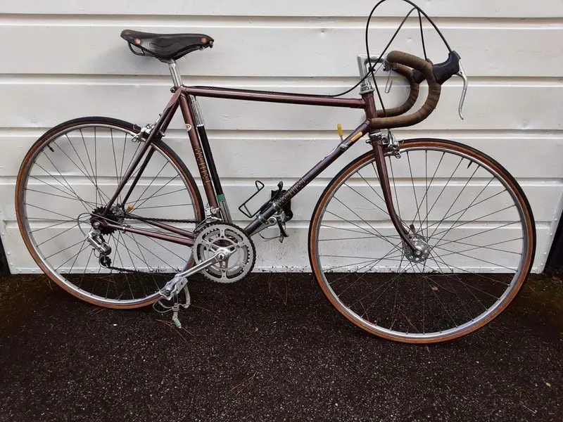

Steel frame bike with Shimano 600 Arabesque groupset
Coxleopard
My bike for sale.
The full description is on the Ebay listing here.
the frame is just a little too small for me. The guy who sold me the frame had this to say about it: "...was used and raced in the 70's by [SR BANTING] who was a member of Hemel Hempstead Cycling Club. He thought it might have been made by Condor Cycles."

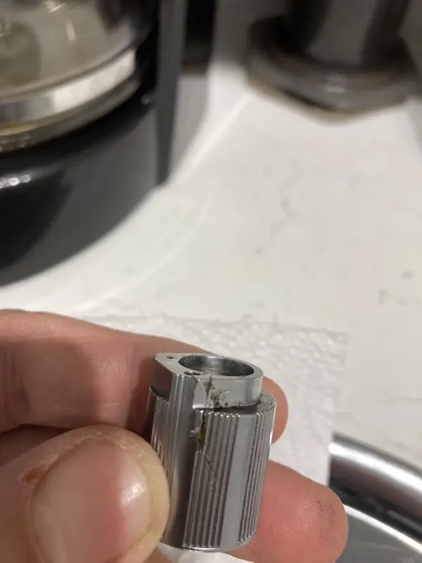

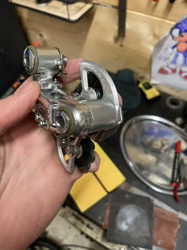

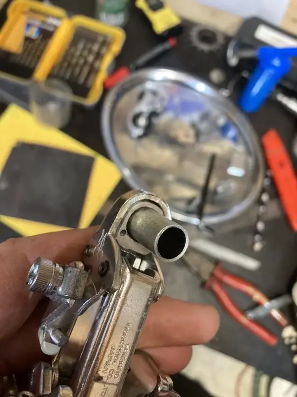

The groupset I wanted was the Shimano Arabesque. And this was probably the biggest task on the build. As is well known, I think, the plastic part on the rear derailleur perishes. This one was on its way, and rather than wait for it to break I thought I'd replace. Photos below show the process.
Original plastic barrel, showing a crack in the plastic.

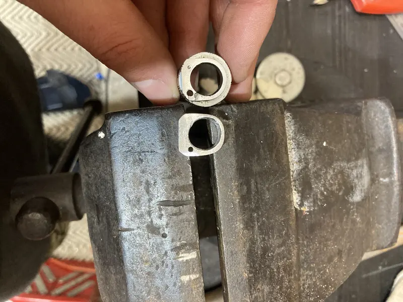

Replacement spring holding part made from aluminium, next to original part.
Showing the part in place.
Test assembly.
Aluminium tube installed.
I have the original part, and if anyone who bought the bike would like it, they can have it. Equally, if anyone would like me to do this fix for them, I'd be open to it.

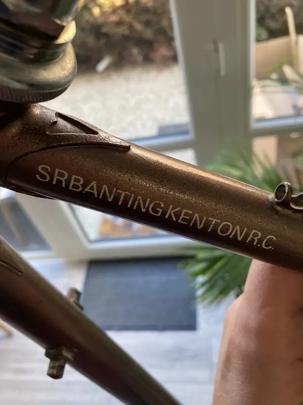

So what is the frame?
The frame had this on it when I bought it (came off with t-cut):
The seller had this photo of the bike in the condition he bought it (as it happens the presence of Arabesque on this bike was a fluke, and made me smile):
It shows the words "Hemel" on it.

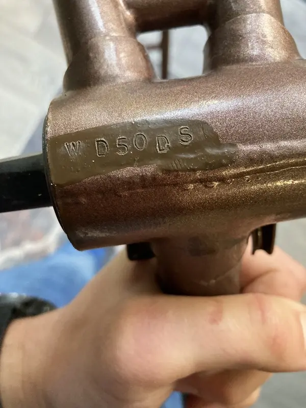

The BB shell looks like this:
And that, it turns out is a post code, not a frame number.

I emailed Hemel Hempstead to ask if they knew SR Banting, and they drew a blank.
So I gave up trying to work out what the frame was and just enjoyed it for what it is.

Yes, that sleeve/locator part seems to crack on arabseque 600 rear mechs. I filled the crack on mine with superglue many miles ago - still going. An early design mis step on Shimanos climb of the tech ladder.
Where did you source the replacement? Or did you make it yourself?
I made it myself. I thought about the glue approach, but liked the idea of making something. I still have the original bit and so glue is still an option.
