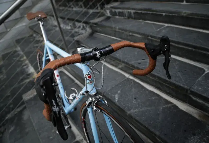

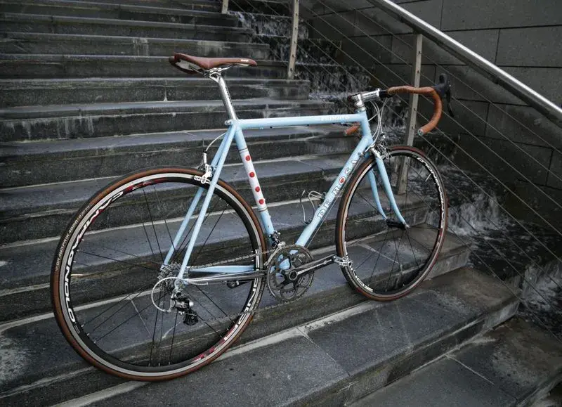

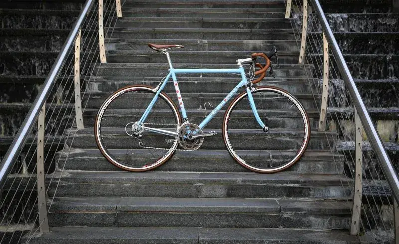

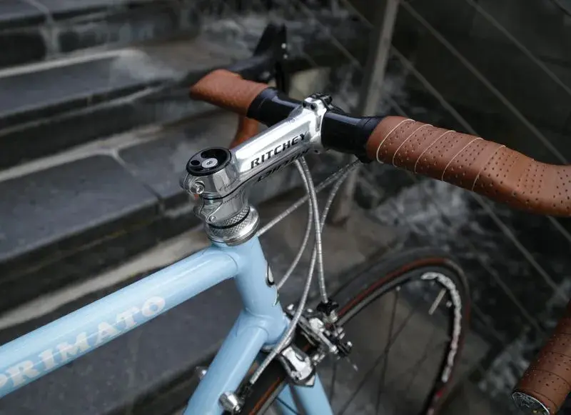

Finally built the bike I wanted!
The objective was to have a steel classic-look frame with modern components. Here are the results:
overall weight is 8.2 kg
Frame and fork: De Rosa Neo Primato (with self-made sticker on a seat tube)
Wheels: Campagnolo Zonda
Groupset: Campagnolo Athena Carbon 11 speed
Brakes: Planet X CNC + Nokon outer cables
Handlebars: NoName carbon (200 g)
Stem: Ritchey Classic with carbon front plate
Seatpost: Ritchey Classic
Seat: Charge knife (215 g)
Pedals: Crank Brothers Candy 2 with ti spindles
Bottle cage: NoName titanium (27 g)
Thinking of buying 38mm carbon wheels, but not 100% sure...
