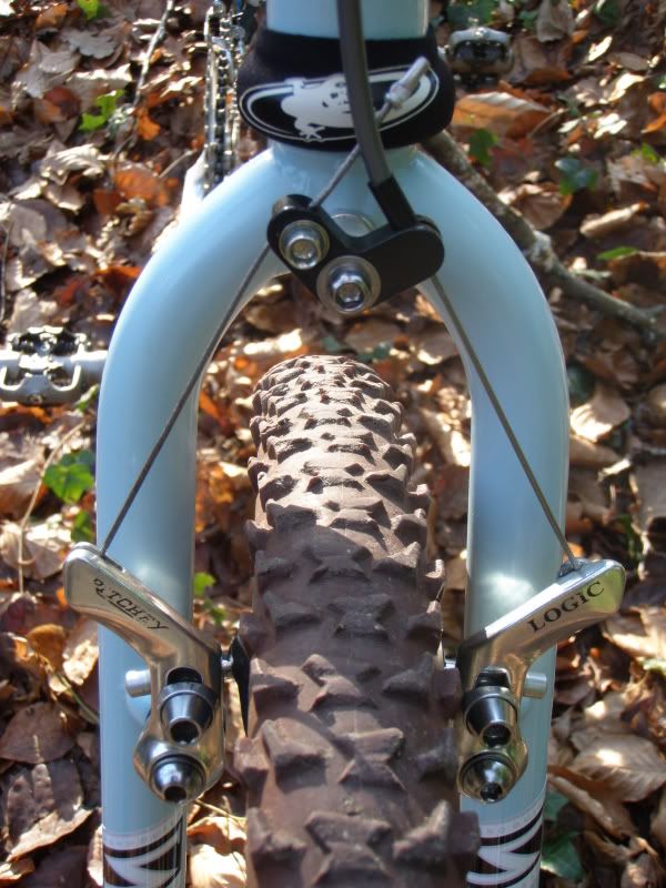

Why not use one of these...
http://www.sjscycles.co.uk/tektro-tektr ... prod14032/
...instead?
Like this...
...much neater, and far less hassle than changing everything else around 8)
