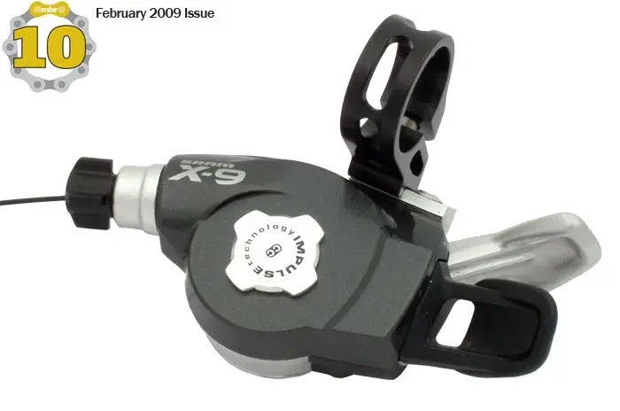

I somehow appear to have lost the shiny bit that holds my X9 cover to the shifter body.As shown in the centre here.
Anyone got one I have have/buy. Or know where I can get one.Or have a scrap shifter I can have.buy.

for the time being can you use a standard nut an a big washer i m guessing its m4 thread but could be wrong
Yeah thats about right, or just use a button head bolt (and then you may decide to not change it out!!).
Can be had cheap on ebay.

Yes, it's M4 thread. Have lashed up 3 washers of reducing size and an M4 x10 cap head screw.Does the job.Well sort of.Luckerly its hiden by teh brake lever.
Cant believe that it came loose.Nor that he carbon look (for that read plastic ) cover was still there. It was teh rattling cover that made me look and find the screw was gone.Bugger.Have contacted fisher outdoors who are the UK distributers.Well see.I expect they'll want £35 and for me to go to my not-so local LBS :(
