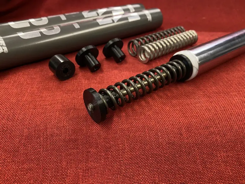

I developed and produce the professional re-build spring kits Made in Germany. Feel free to contact me with further question!

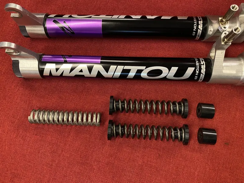

I've gone for these,currently on their way to me;
Have good reports,apparently an improvement on original elastomers. 👍
