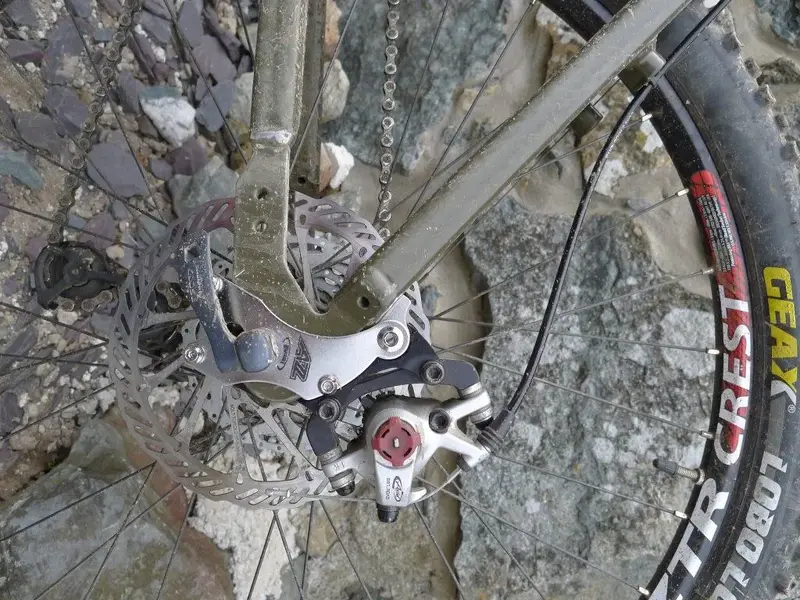

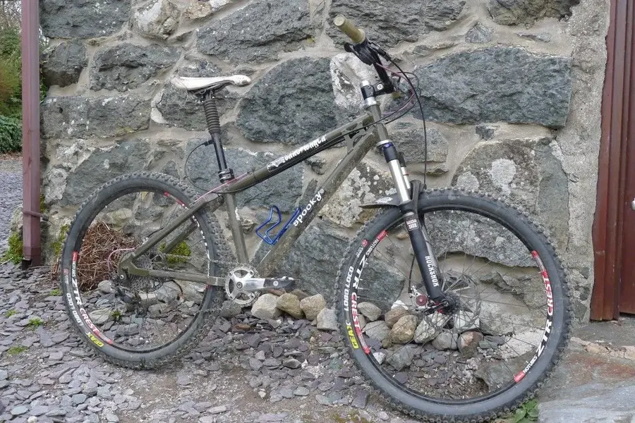

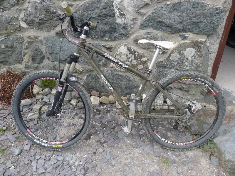

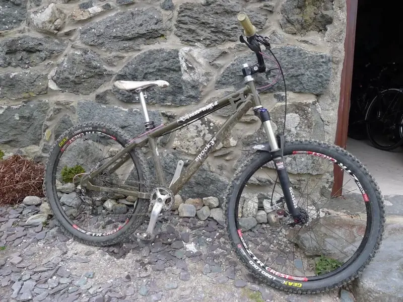

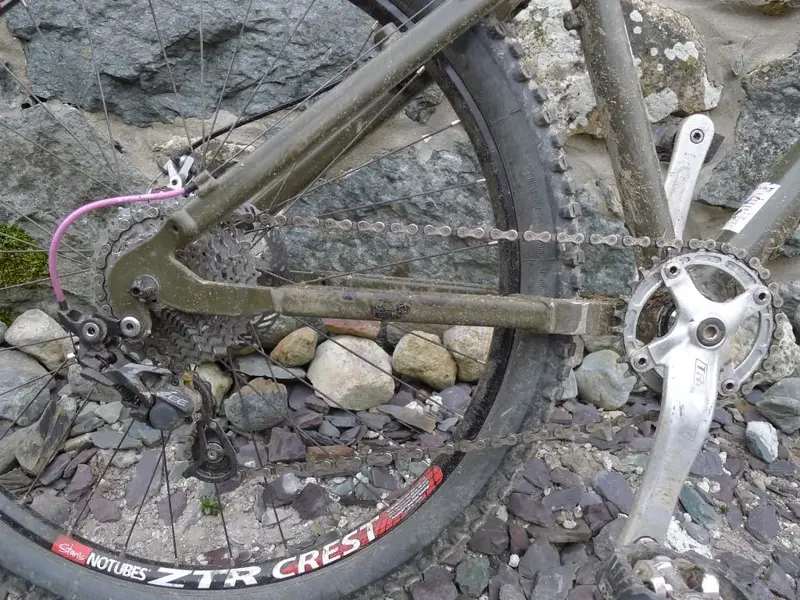

For many years I have loved riding the Spooky Bandwagon, but the retro set up with Marz Z1, XTR v-brakes, Mavic D521 rims and chain device was making it a bit of a cumbersome mud magnet on longer rides. So...
I abandoned the search for the elusive Spooky disc mount/Hope calliper and bought an A2Z universal mount, stuck some coil Rock Shox Sektors (run at 100mm) on there, upgraded the drive chain to 10 speed with a clutch mech and Works narrow-wide chainring, and fitted some tubeless Hope Hoops. I've also reamed out the seat tube to take a 27.2mm dropper post. Probably blown the warranty on the frame (hahahahaha).
The result favourable. Rode the Beast at Coed y Brenin this afternoon and it flies. Albeit standing up for a couple of hours wasn't great, but also not unbearable. Going to rivnut a bottle mount onto it tomorrow. This bike has a whole new future ahead of it... yee woo hah hoo.
