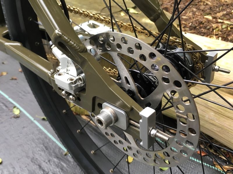

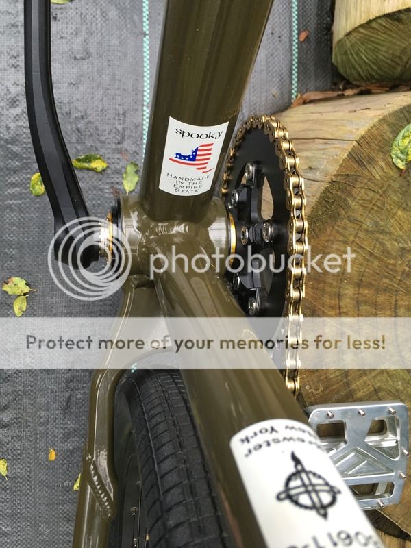

The guy who was advertising it originally purchased it from another guy in the states. The original seller didn't know much about the frame or what he really had but from what i could gather it may have come from some sort of stock clearance from a store closure. It was probably part of old stock languishing in the back of the warehouse. Anyway, it soon made it's way to the uk and then in time readvertised on eBay due to circumstances, which is where i came along. I purchased it together with a Hope hbrm165h rear brake adapter.

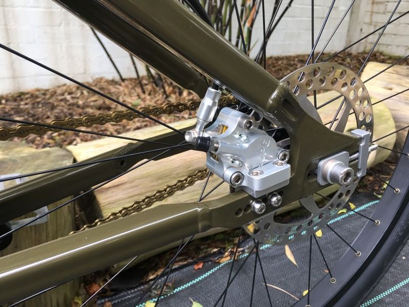

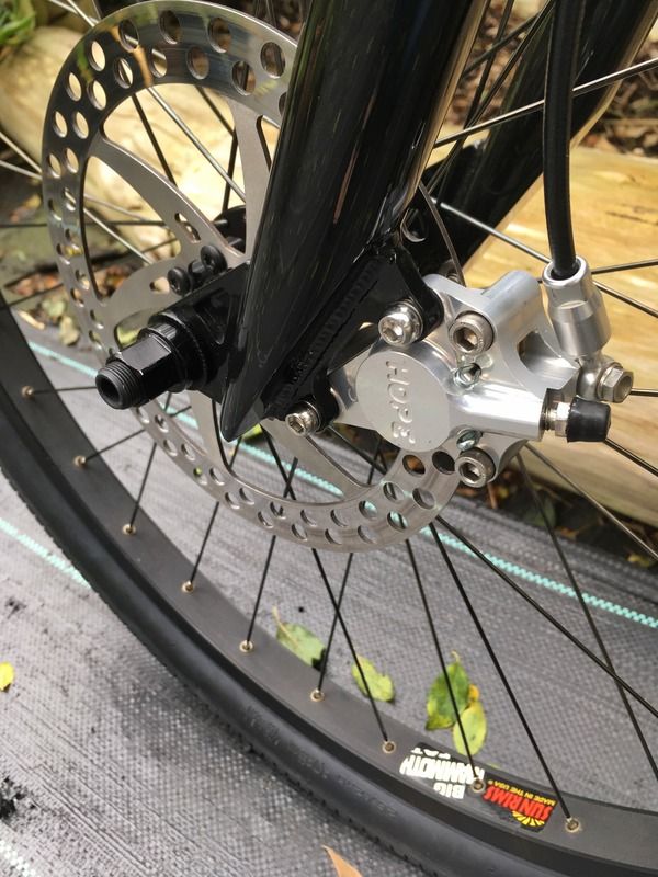

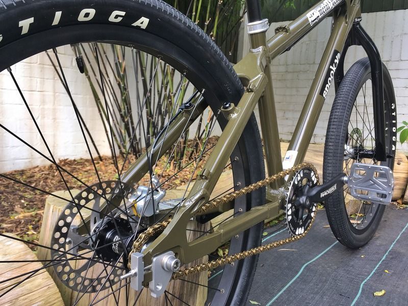

Everything which was collected for the build was NOS apart from the rear hub, Azonic pedals and the Hope C2 brakes/levers. The brakes gave me the biggest headache trying to put together a complete mint looking set. I certainly bought more than what was needed, but they look the part now. I also have a pretty much mint spare set too now which is handy, should they ever be required at some point.

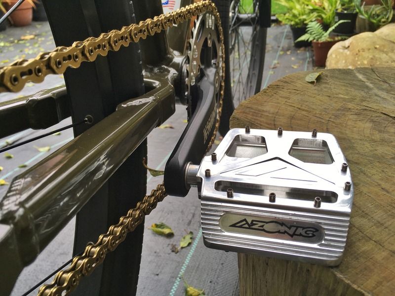

The pedals although good needed some work to get them looking as they do. They had scuffing to the outer edges which needed some sanding and polishing. It took some time but they look pretty much like new again and compliment the other Azonic parts.

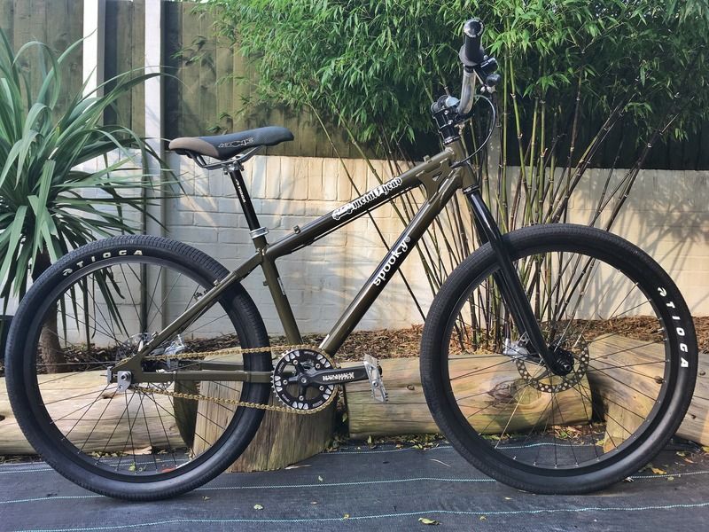

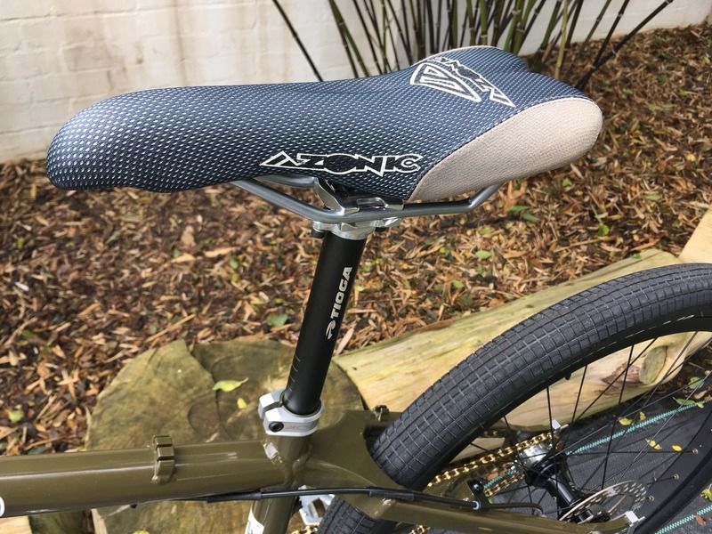

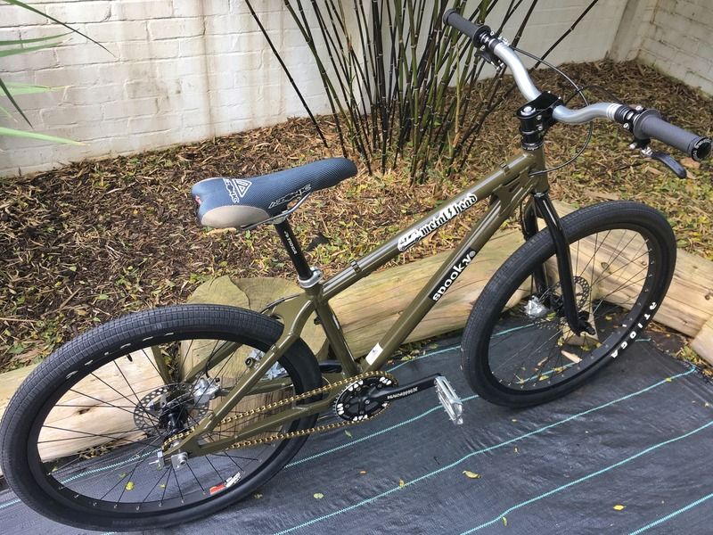

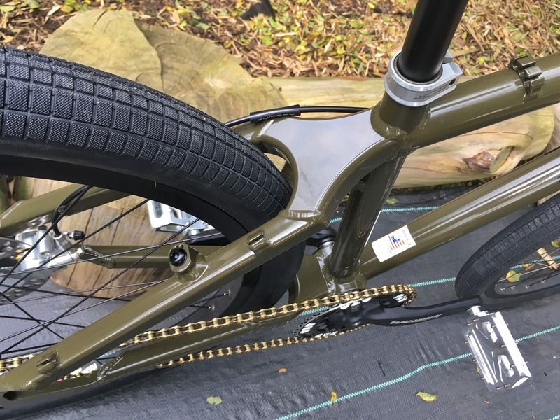

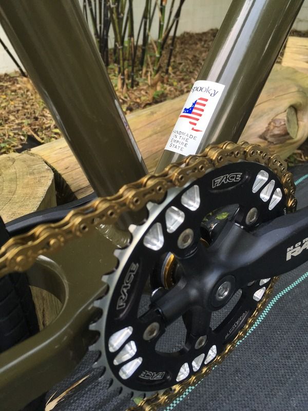

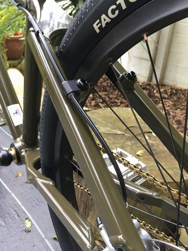

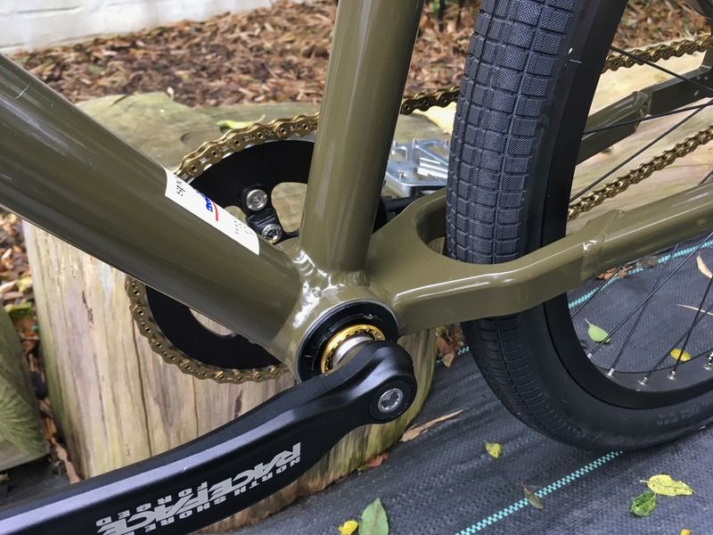

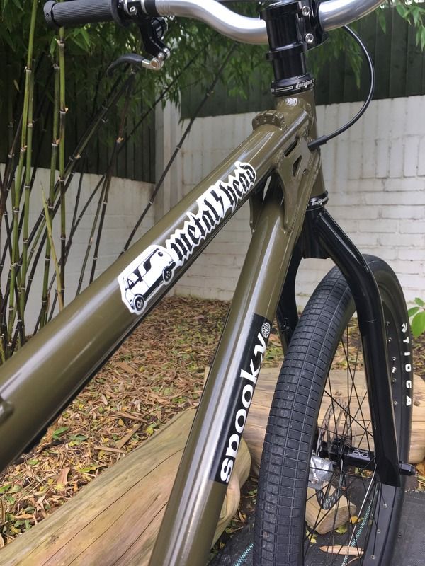

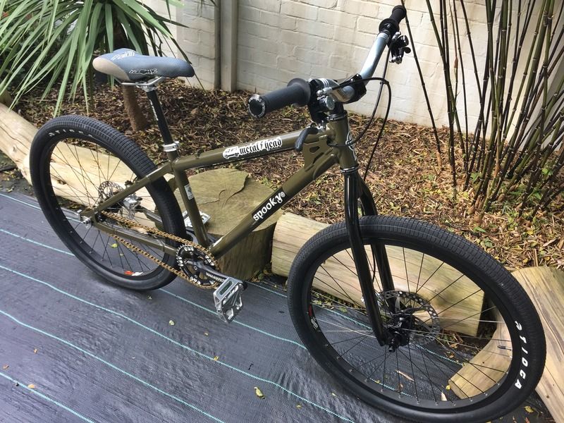

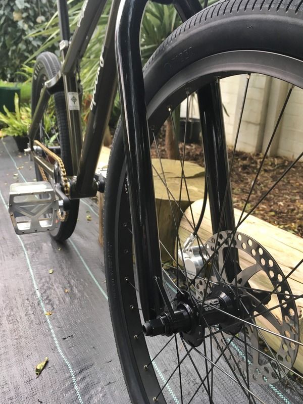

here is what we ended up with....
and thank you for you patience :wink:
-Spec-
Frame: Spooky Metalhead
Fork: Identiti Rebate XL 1420

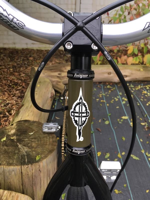

Headset: Hope
Stem: Azonic Shorty Deluxe 28.6/50mm

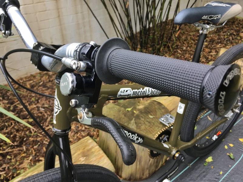

Handlebar: Azonic Chubby 2.5"
Grips: Tioga MX Comp Lock-on
Brakes: Hope C2 185/165 / Tioga Brake Tamers
Cranks: Raceface North Shore DH 94 pcd
Crank Bolts: Raceface M15
Chainring: Raceface DH 40t
Chainring Bolts: Stainless Steel
Cog: Andel 17t / Miche lockring
Chain: KMC K710sl
Bottom Bracket: Raceface ISIS Signature DH 118mm / DMR Wondercups mk1
Pedals: Azonic A-Frame
Saddle: Azonic Hot Seat
Seatpost: Tioga T-bone 26.8
Seatpost Binder: Azonic 31.8
Rims: Sun Big Mammoth Fat 32h
Hubs: Hope Pro 2 Evo Trials rear/20mm front
Nipples: Brass
Spokes: DT Swiss
Tyres: Tioga Skidrow FS100 2.10
Tubes: Kenda presta
