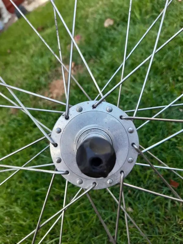

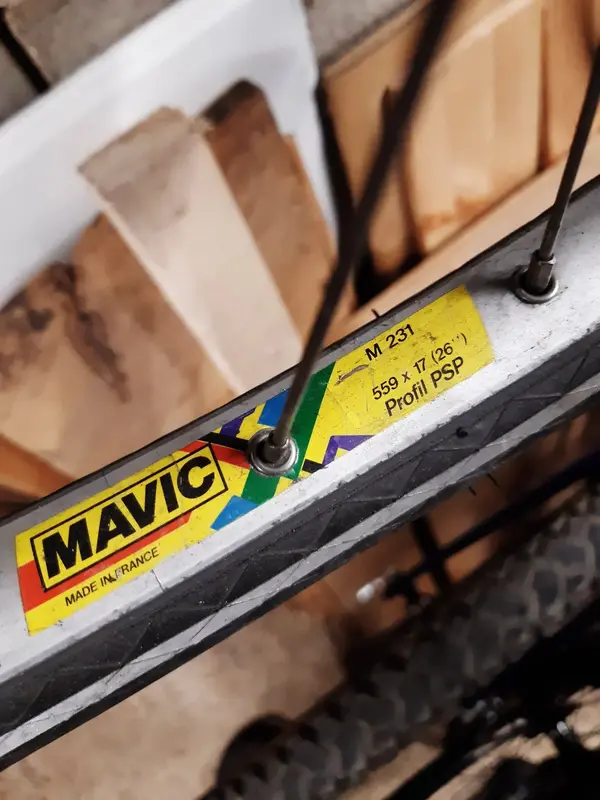

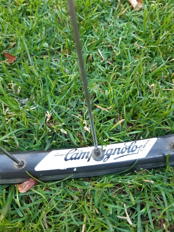

I have a White Industries rear hub which I'm putting onto my Work Bike Mavic M231 rim. Iv'e never been a 'Spoke Guy' and I don't know what spokes to buy in order to facilitate the wheel build. The rim and hub are 32 hole.
The images here are of the Mavic rim, currently build on an XT hub. The others are of the White Industries hub build up on a Campagnolo rim.
The question is the obvious one, what spokes do I buy for the rear wheel, web links would be best so I can just click and buy.

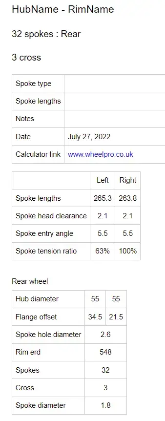

Sapim or Spocalc to work out spoke length, most have hub data but you might need a vernier to check the WI one. Then off to the retailer to order. My local bike shop is every bit as competitive as the web guys, and sells online. http://www.forgecycles.co.uk/Home
