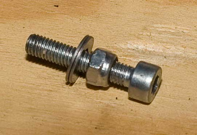

If you don't have a rivnut tool, luckily I do :mrgreen: , there is a way to tighten rivnut again. Find an Allen bolt, and a nut, the same size but a decent bit longer than the bottle cage bolt. Screw the nut onto the bolt far enough that the remaining threads will reach through the threads in rivnut. Now screw it in to rivnut bolt with a washer between the nut on bolt and face of rivnut, making sure the bolt is far enough in to grip rivnut threads properly, you don't want it chewing them up. Now whilst holding the bolt with Allen key, tighten the nut on bolt AGAINST the rivnut so that it squeezes the internal part of rivnut till it's tight in frame again. A drop of lube between washer and nut on bolt will help it turn without the washer turning rivnut, keep the lube away from between washer and rivnut. If the rivnut tries to turn while turning nut push the bolt sideways to rock rivnut in hole to help stop it turning. Again, it won't always work as the hole in frame may be distorted or the rivnut won't compress any further.

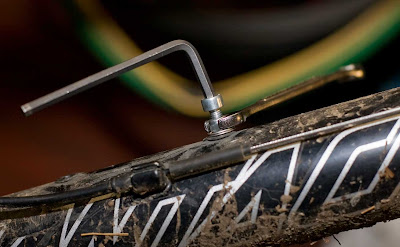

Woz":3dlokcrs said:
Good idea to use the mech to hold the rivnut. I'll remember that for the future. Maybe even adapt it to use 2 Jubilee clips, one above and one below rivnut.
The method for tightening the rivnut is same as I described. 8)

old_coyote_pedaller":1ogy0vsz said:
Here's the pics from the link, maybe should have added whole page?
Using the FD as a clamp will probably not work in case the loose rivnut is on the down tube due to different diameters.
I played with the idea of one large width jubilee clip with a hole drilled in it if ever I had the problem.
