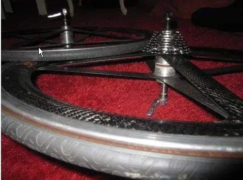

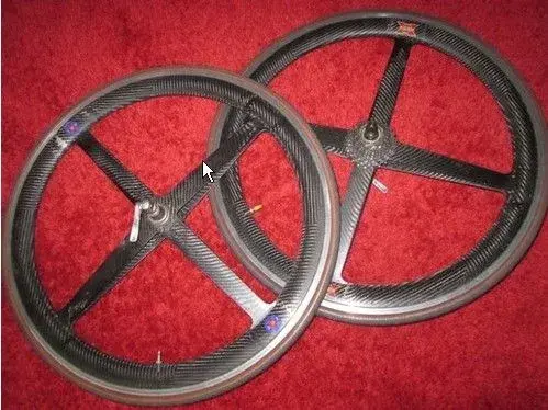

Been searching the Internet and the forum but can not find out if Synergy built specific MTB REV X wheels or not ?
I just got a set of Synergy Rev X wheels which ar 26" which I believe were used on a road bike
Any help would be appriciated

There are small stickers on the wheels that say REV X ROX
The Spinergy Rev X series came in the following variants:
26" (MTB)
650C (Triathlon)
700C (Road)
Indeed axle widh differs but also note that rim diameter is not the same for either variant. MTB tires do not fit on the 650C rims.

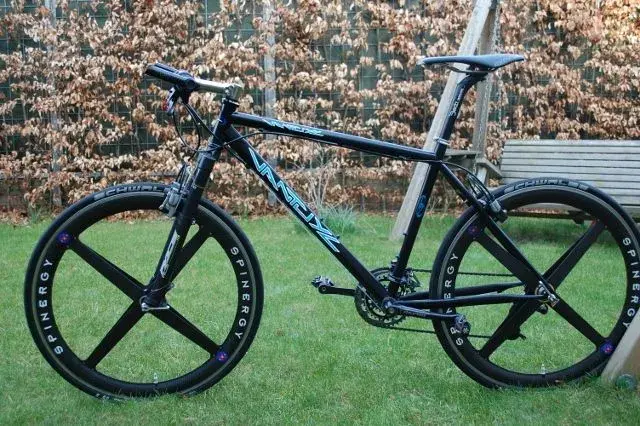

It is possible to fit 650C rims on a MTB. Only the brakes to have to bre adjusted slightly higher on the cantilevers/brake bosses. I use the 650C variant on my bike for road trips.

The 2 bikes above look sweet with the Synergy wheels.
