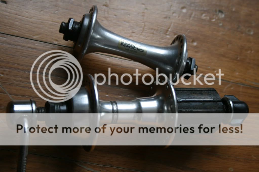

will a Shimano FH-M565LX (Deore 8 speed) work?
So i found a very cheap Shimano 600 Hub:
the guy says it had a 9 speed cassette on it..
but Sheldon says:
Shimano 600 - Became 600EX when indexing was introduced, 600 Ultegra (Gray finish) when 7-speed added. When it became an 8-speed group, the 600 designation still existed, but it was usually referred to as just "Ultegra". With the '98 model year, 9-speeds came in and the "600" designation was completely dropped from Ultegra.
so it must be an 8 speed freehub right??
UPDATE:
http://velobase.com/ViewComponent.aspx?ID=4467426a-0623-45b7-a3c9-0df1afa9bef0
http://bike.shimano.com/publish/content ... le.html/07)%20Hub%20Specs.pdf
= Hyperglide 8/9/10 Speed compatible! :P

well eight and 9 speed have virtually no difference at all anyway......should be fine 8)

taken the campy cassette and freehub off.. what next?
The forum software doesn't like some URLS. Don't use the [ url ] tags, it should work then.
Thanks john.
Right you should just need to remove the freehub from your donor hub and thread it onto your spinergy wheel hub...just a matter of fiddling with the donor cones and spacing then... 8)
