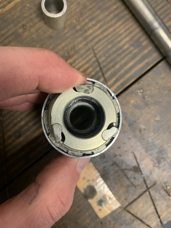

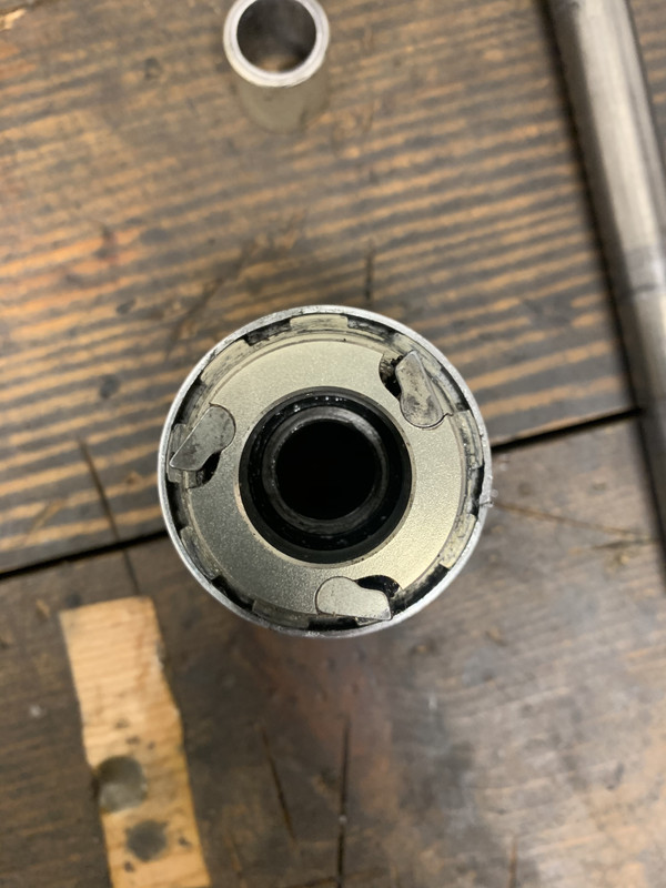

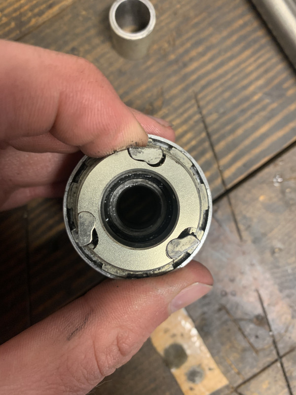

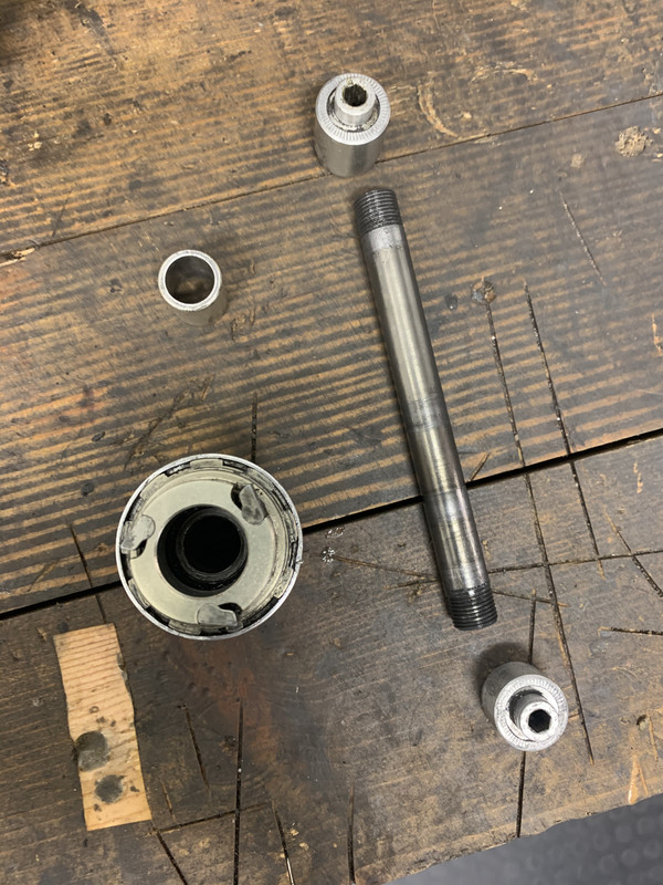

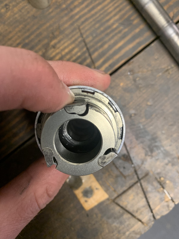

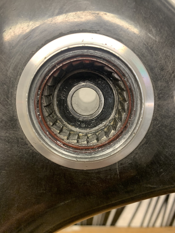

So I’ve taken the rear hub apart now and only issue I can see is one set of pawls seem to have a lot of movement when depressed.
I’ve attached some pics of me pressing down one set that’s normal and then a 2 pics of the not normal one. They depress but move forward slightly. Not sure if this is the issue ?

I'd get a tin of degreaser in an aerosol preferably with a straw, blast out each pawl until all the shit is out & the liquid is running clear.
Then blast some GT85 through & let drain, clean it up & then pack each pawl with marine grease (other greases are available) then reassemble & give it a try, my as well fit new bearings while you at it!
As mentioned a good potential problem is the free hub pawls.
But check your jockey wheels in the mech - if sticky they can cause problems as you describe, and can cause misdiagnosis of the issue. Also check the B screw has enough tension. And it can be all three: jockey wheels, B tension and pawls.
If definitely free hub, a roaming bit of grit in the pawls or the grease being the wrong consistency or the pawls being dry (which looks as thought they are) or all three. Nothing serious - happens all the time. Good advice in the previous posts.
Silicon is your friend on the hub seals - not standard great. Light mineral or synthetic grease is your friend on the pawls and the inside of the hub. As mentioned flush out the pawls very well with GT85, then dry. Install very light grease. Wipe all seals with a very very thin smear of silicon grease - stops water ingress. Excess grease around the axles and seals does tend to draw crap past the seals - I doubted this until I experimented. Rotation causes grease to circulate around the seals, and weird turbulence (the area of physics which is as mysterious as black holes) causes ingress I think. That's why a light hydrophobic coating of silicon grease seems to work really well.
