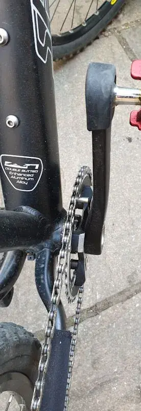

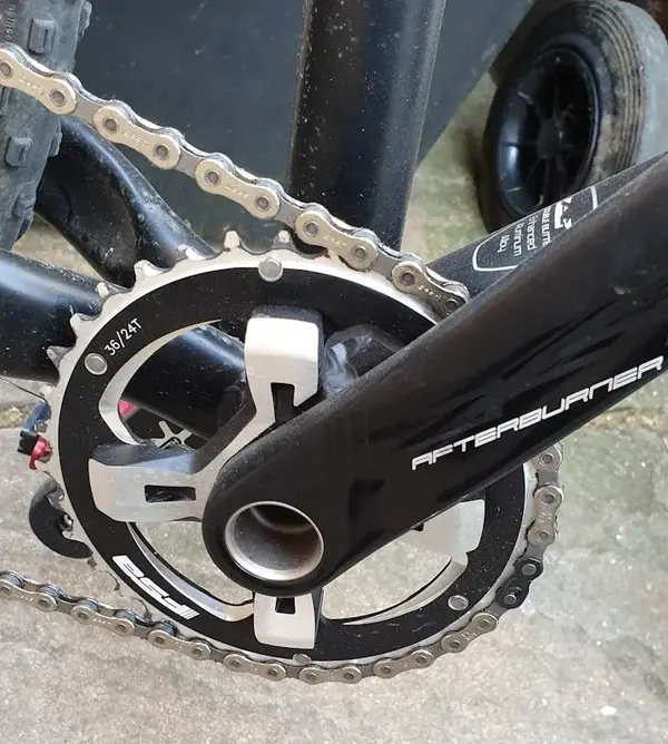

I have these (well not these, as they are on my wife's bike, but another set). Whilst 2x, they seem to put the outer ring where the middle ring on a 3x would go.
Would they give a decent chain line?

I'm running similar on one of my bikes (3x crank converted to 2x).
No problem with chain line, at all.
