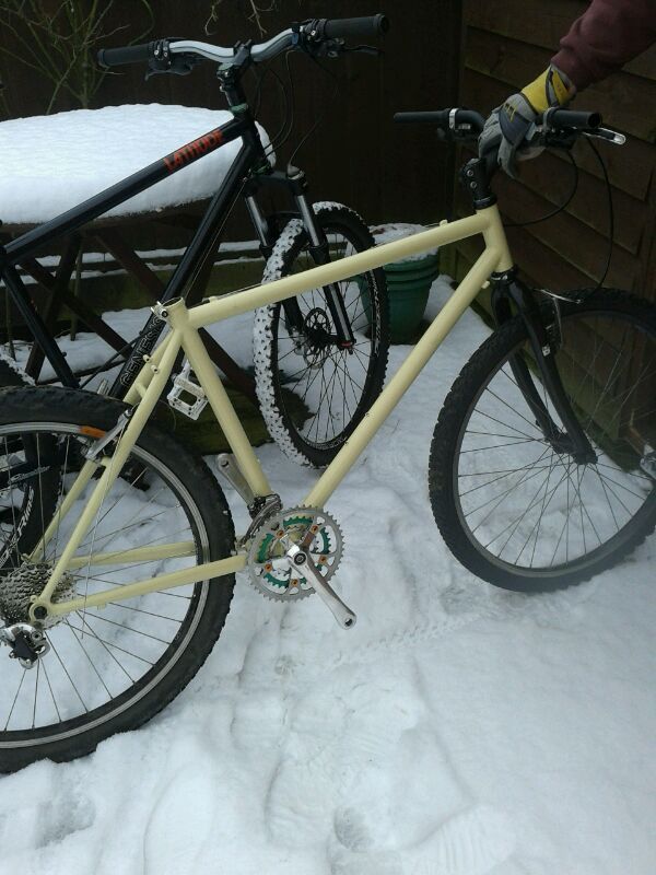

Had a few issues with the threads of the bottom bracket, so took it to my lbs to get rid of the small amount of paint that had got on the threads. Now ready to finish...has taken so long! Sorted specialized wheels and a few bits so should be good to go in a few weeks...

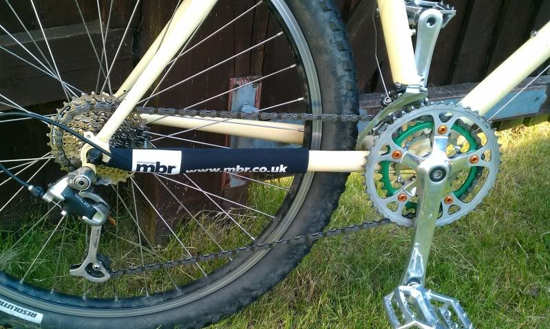

loving the shim chainset.....i think it needs more green annodized.....
really goes well with the "old english white" ykt!! :D
Yeah I quite liked the green - by coincidence rather than design as it was what I had lying around. :D

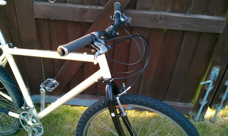

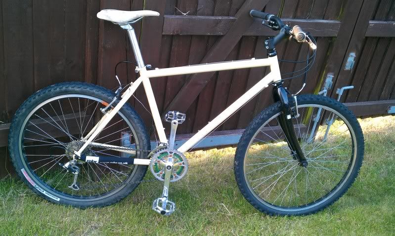

Need to tidy the cables up and tidy a few small things up like grips (just whacked on for photos) but otherwise it is ready.
Oh and I need to sort the indexing out, it shifts up ok (front derailleur) but downshifts skip the middle - too much/not enough tension? Part of the reason for the painful long build is:
(a) I struggle with time so when I get free time I would rather be riding
(b) I don't have a clue when it comes to builds, how to set up gears, cables, etc. I have done everything on this bike so I'm am more pleased with it than anyone looking at it would be because of the sense of achievement! It's been a good learning curve, and once I can sort out the skipping shifts I will be a lot more confident to turn my terrible mechanical skills to another (perhaps more premium) build :D

Front mech, probably best just to start again with that, unclamp the cable and make sure the shifter is clicking through cleanly in both directions (if not blast it's insides with GT85 or whatever). Then with it in the granny gear position and the adjuster barrel screwed right in, pull the cable fairly tight by hand and nip it in place - that should give you a good start point to fine-tune from 8)
