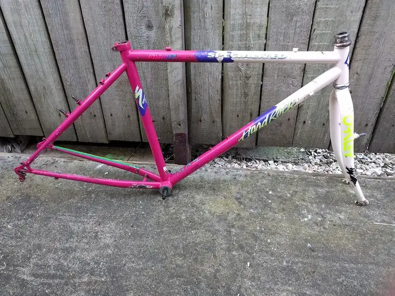

I'm in the process of rebuilding a 1989 Hardrock comp. The parts have cleaned up nicely, just after a bit of advice regarding the BB and wheels.

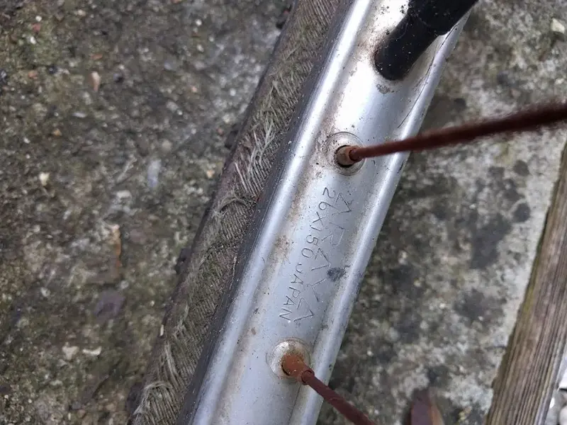

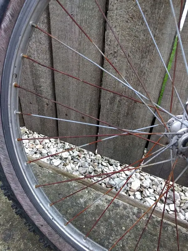

Also the spokes are rusty, rims seem fine, from the images would you say they are worth cleaning up.

On the BB yes, you are on th eright lines - shell and shaft length are the key dimensions.
As for the spokes, personally I would re-lace with new stainless double-butted spokes, but I build my own wheels so it's a cheap option. For around £50 you can get a decent set of used wheels, which iwll be around the same as getting a shop to build them I suspect. It depends on how much you want to spend.

Not much, not sure what I'm going to do with it. Think I'll keep an eye out for a used set of wheels or donor bike.
Those would work yes.
However personally I would look for a period upgrade set.
That colour scheme on the Hardrock is awesome, so typical of the late 80's.

Ideally I'd like the original araya mp-22. Might put the Weinmann TM19s on so I can ride it and keep an eye out for the araya.
Not sure how much the wheels are, they may cost more than the bikes' worth.
