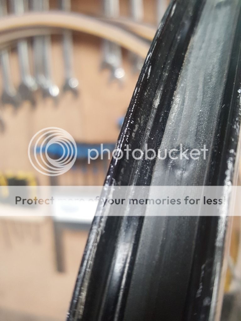

A second tube has blown because the tyre has bulged and come off the rim.
I assumed it was the original old tyres on the bike that had perished, but it has a new set, and new tubes and it's burst again.
Everything looked seated and fine at about 60psi, at 100psi I left it and it burst.
what rims are they? "hookless" rims (which are back in vogue for mountain bikes....) are meant to run lower pressure

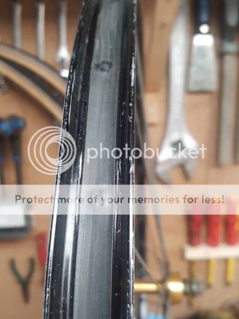

No, the rims are completely smooth. They're weinmann rims on a raleigh record sprint.
No hooks at all.
So try again at a lower pressure!?
The old tyres that came off didn't seem special, but I didn't take a great deal of notice
yup, I've been poking around the internet and "about 60 psi" is the best I can find for a limit for road tyres
the hooks came about to stop the problem you've been experiencing at higher pressures
I have a couple of bikes with Weinmann unhooked rims and have experienced similar problems when inflated to higher pressures. However, in my experience these seem to work fine running at about 60psi.
