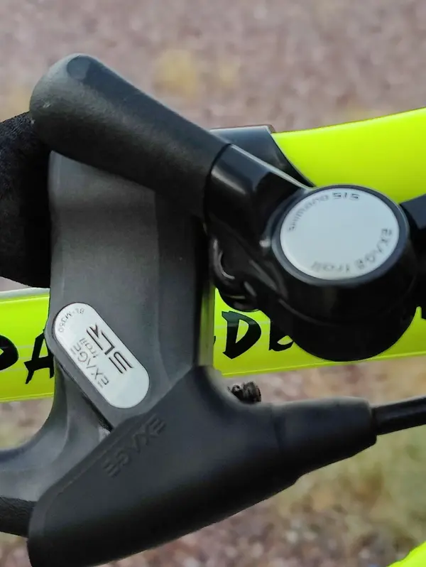

IMG_20211017_143523.webp IMG_20211017_174718.webp hi th IMG_20211017_174807.webp
Hi there! I know this thread is old but I just found this Marin Palisades. Trying to find the year. If you're right them this would be an 89 as well. Found this in pretty much new condition! Oh this bike is from the US.
