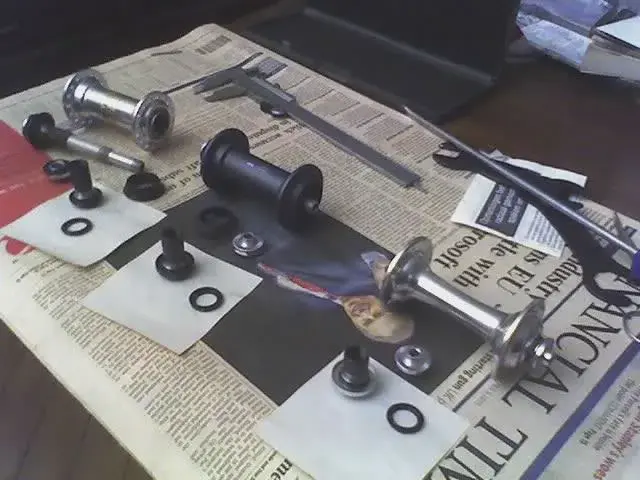

I've just stripped an XT 738, an XTR 950, and a Dura Ace 7700 front hub and measured the cones and seals, counted the balls in each, and tried various combinations of hub, cone, and seal.
The XT and DA seals are, as far as I can detect, identical. The XTR seal is a little different.
XT/DA:
internal diameter: 12.3mm
external diameter: 18.2mm
thickness: 2.6mm
XTR:
internal diameter: 12.8mm
external diameter: 19.0mm
thickness: 3.0mm
I tried the Dura Ace seal on the XTR cone. With a little massaging it will seat evenly around the base of the cone. Popped into the open cup of the XTR hub it makes good contact all the way round. On balance I'd say it should work as a contact seal on the XTR hub.
The Dura Ace hub comes, as advertised, with 11 balls per side. The XTR would seem to have ample room in the cup for 11, but only comes with ten. It's obviously designed as such. The axial ridges on the cones are designed to pass between the balls; the DA cones have 11 ridges, while the XT and XTR cones have ten.
The XTR cone seems to work in the XT hub. The XT cone won't fit the XTR hub: the smaller pressed-on dustcap of the XT cone fouls the dustcap of the XTR shell. Neither the XTR nor the XT cones fit the Dura Ace hub, and the Dura Ace cone won't work in either of the other hubs. The dustcaps foul in every combination.
All three axles have rolled M11 threads on a base diameter of just over 10mm.
I found a reliable way to seat the XT seal evenly on the XTR cone is to place the seal gently in the opening of the hub, flatter side inwards, with the bearing balls in place. Then carefully slide the cone into the shell and press it firmly against the balls. You can use the axle to guide it in. If you now withdraw the cone, you should find the seal correctly and evenly seated on the cone.
