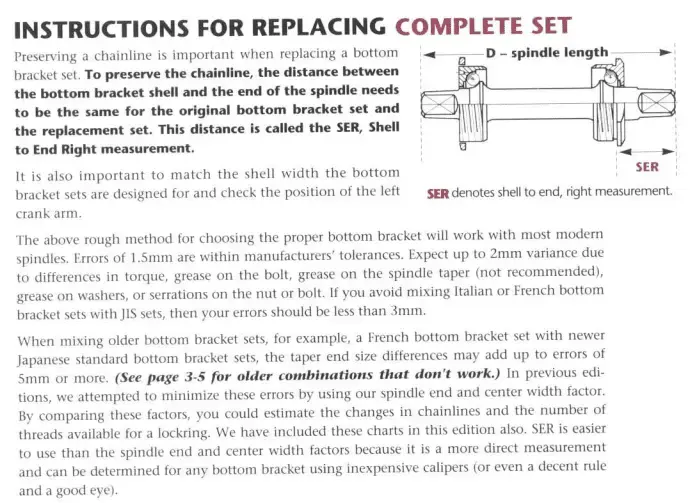

Here you can go mad. (using an old book from back in the day)
What the spec wanted is D-3A (well actually 3A 'nut type marking') for the original crank and setup.
A move to the modern 118 (XL118 shimano cartridge) places the SER (that frame shell edge to end of axle) is negligible.
With an MM107 it moves the SER to 19, so should shift your ring in 6mm, which is about what you need.
(for anyone else reading or using these) It should be noted, some years back a few people on here measured the MM107/MM110 when fitted and found the SER stayed the same, just the drive side shifted. That could be just Shimano (newer) doing it differently or other manufacturers may be doing it this way, or vice versa. I cannot remember.)
