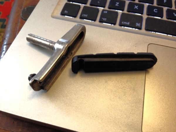

Does anyone know if you can still get pads to fit the Shimano cartridge holders in the photo?
They are STX RC pad holders from a cantilever brake and the pads are approximately 63mm long. Pad holders are front / rear specific too so I'm guessing the pads have to be as well.
SJS have a load of Kool Stop cartridge pads but none are the same as these. Just wondered if anyone knows of anything currently available that fits?

The replacements are difficult to find. It's the Shimano M65T inserts you'd need for those LX pad holders. The XT and XTR cartridge pads were the M70/R versions, ie 5mm longer.
As far as I can tell there are no after-market versions of these pads available, so if you can find replacements then you are stuck with Shimano's rim eating pad compound.
I'd like to be corrected on this because I'd like a stock of non Shimano replacements for mine...
CRC were selling off a load of NOS LX M565 canti sets a while ago for a very reasonable price. You could I suppose buy a set just for the pads, but it kind of defeats the point of replacement cartridge brake pads as you'll still be left with another set of cantis needing new pads.
