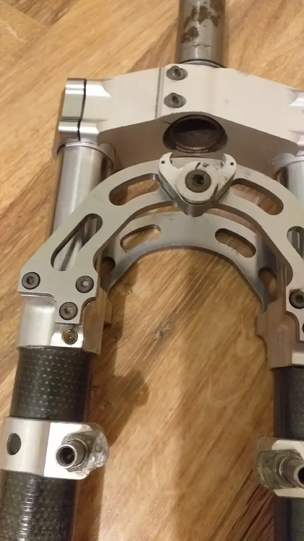

Hi I'm in the final stage of my 1995 p7 build and
Whilst going to fit the front brake cable to the hanger
When I tightened the hanger bolt it pinched it tight to brace so it had no movement.
After looking at the bolt its fully threaded .
I'm assuming the forks I bought have the wrong bolt and would originally had a partially threaded bolt so as to secure the hanger and allow movement.
Just wondering if anyone can confirm this .
And also has anyone got a spare bolt maybe ?
The pic is of a hanger the same as I have (not the actual 1 )
Any advice appreciated thankyou
