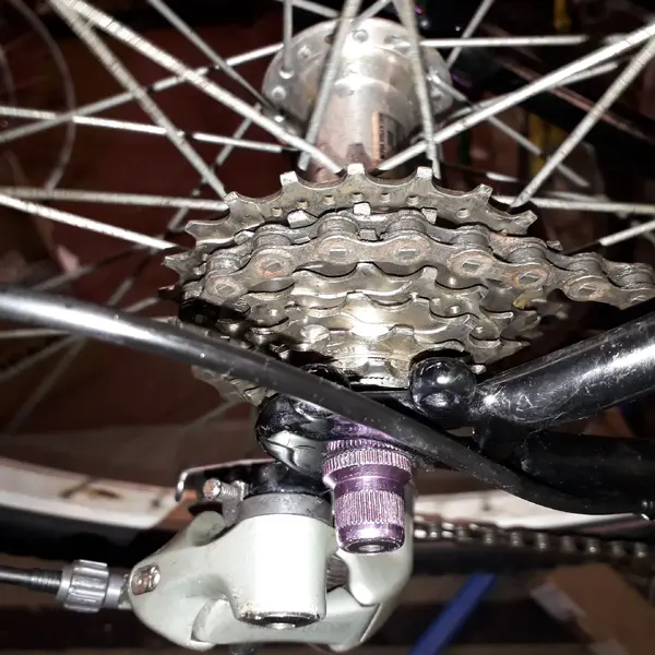

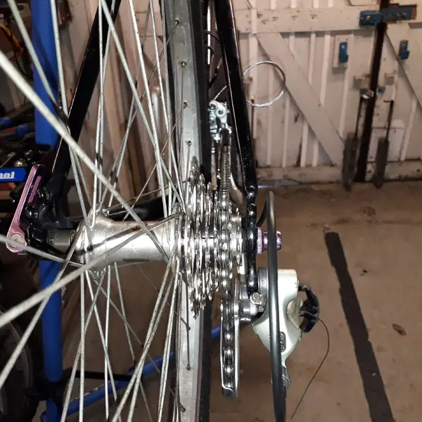

I've got a 105 chainset and the chain I have rubs the inside of the outer chainring, the only cause I can deduce is that the chain is too wide. I may be wrong but I can't test my logic as I don't have a chain that I can compare it against.
The only other cause could be the chain is very worn and is pulling against the chainring due to the slackness in the links, but, as i've said, I don't have anything else to try.
That's why i'm after a lightly used chain that was used with this setup to test my theory. Maybe I need a narrow chain ? Your guess is as good as mine ;)

Many road chainsets with 39/53 will rub the inner edge of the large chainring when on the smallest rear sprocket. This is especially the case with frames with short chainstays. There may be nothing wrong with your setup at all.
It's just the way it is, and cross-chaining like that isn't a good idea anyway.

that's exactly correct!
but there is one more reason. The reason hamster explains will be worse if you are using a chain that is wider than the chainring you're using. eg. using a 8 speed chain on a 9 or 10 speed chainring will mean it's a bit looser laterally on the chainset and have the ability to wiggle a bit more. Despite this, its still useable and provided everything at the back matches, will still shift successfully
