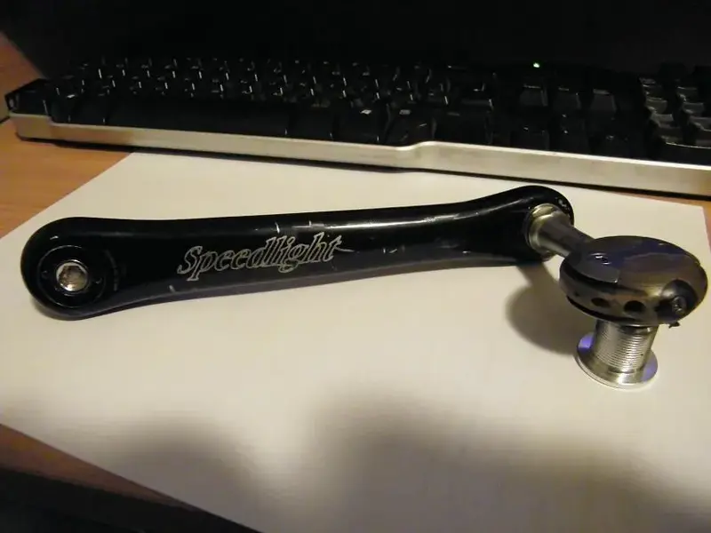

I'm not 100% about the Stronglight chainset. I really like it and i think the bike is going to need some black around the BB area but i have a pair of 600 arms aswell so I think it will come down to what looks/works best when i start building her up.
I rebuilt the Speedplay pedals today. one of the most simple bearing changes i have ever, down a really easy job :D

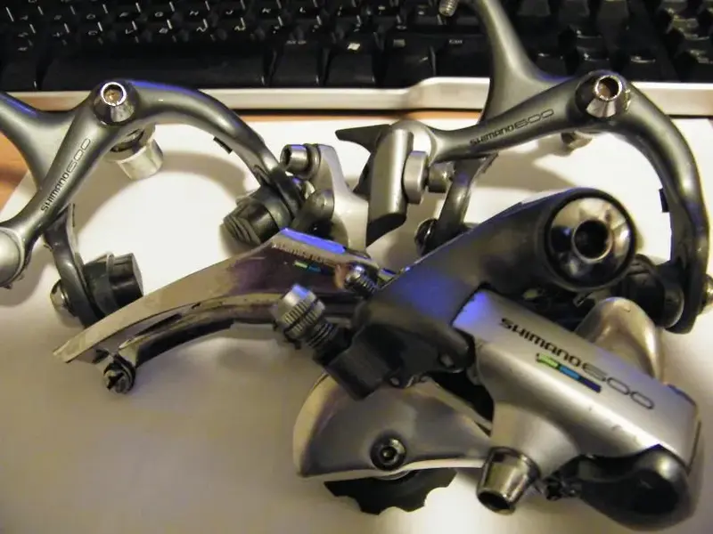

600 Ultegra braze on front mech and rear mech
600 Ultegra single calipers(i'd like dual pivot but i haven't bagged any yet :D )

Stronglight Speedlight crank arms with 38-48 TA spesh rings

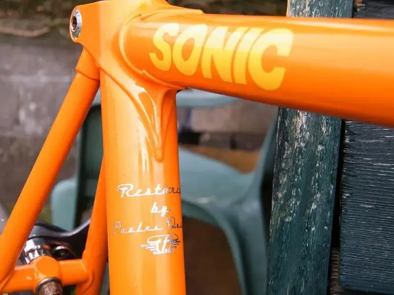

Final coat of topcoat is going on this afternoon :D
Would have been last week but somebody misplaced the tubing decals :oops:
I'm going to pick her up on friday 8)

Re: Sonic cycles resto. Frame returning on friday 8th feb!!
Picked the frame up a day early :D

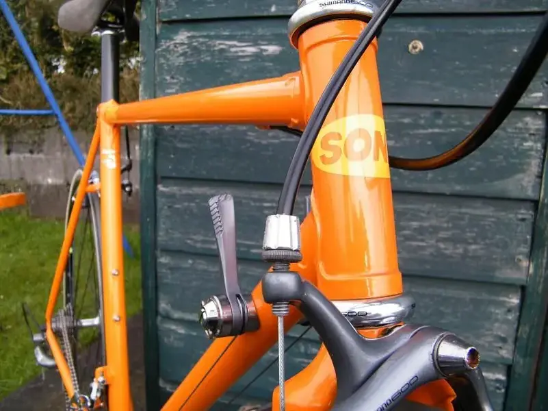

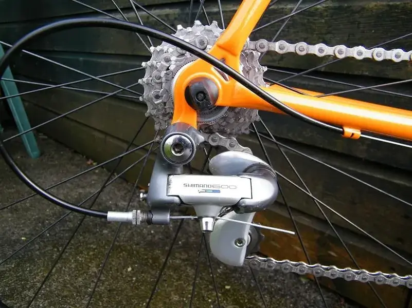

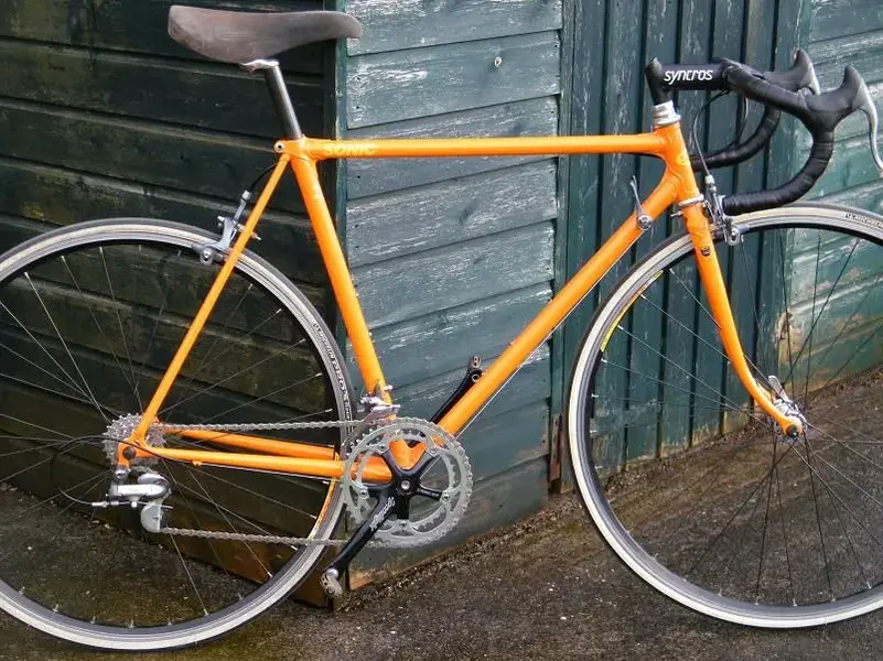

No sunshine but here goes :D
I opted for Dura ace 8 speed DT shifters and cassette in the end.
I'm hoping to fit the matching brake levers but i'm having some issues with them :roll:

Finally got to the bottom of the Dura ace brake lever saga. I had to use some older ferrules on the cable outer where it locates in the back of the lever as a modern 6mm one just pulled through :? all sorted now though.
The final build is as follows;
Frame - Sonic Colombus Nivacrom Custom
Forks - Reynolds 753
Headset - Shimano Ultegra 600 1" cartidge
Stem - Syncros 1" 115mm c/c
Bars - ITM Millenium carbon 44cm
Brake levers - Shimano Dura ace 7401
Brake calipers - Shimano Ultegra 600 Tricolour 6400
Shifters - Dura ace 8 speed(7403?).
Front mech - Shimano Ultegra 600 Tricolour 6400
Rear mech - Shimano Ultegra 600 Tricolour 6400
Bottom Bracket - Shimano UN71 107mm
Cranks - Stronglight Speedlight
Chainrings - TA Specialities 38-48
Pedals - Speedplay
Cassette - 8 speed Dura ace(7403?)
Wheels - Mavic CPX 22 on Shimano 105 5501 9 speed hubs
Tyres - Michelin Racelight 3
Seatpost - Carbon fibre, maker unknown.
Saddle - Brown suede, possibly Turbo certainly looks like one :D
She is a bit of a mishmash but i think she looks lovely and on the plus side she rides really nicely too 8)
20 mile shake down test today. All good apart from the saddle was a smidge high with my padded tights over my padded shorts :D
Speedplay pedals are a dream 8) and 16 gears is more than enough :wink:
