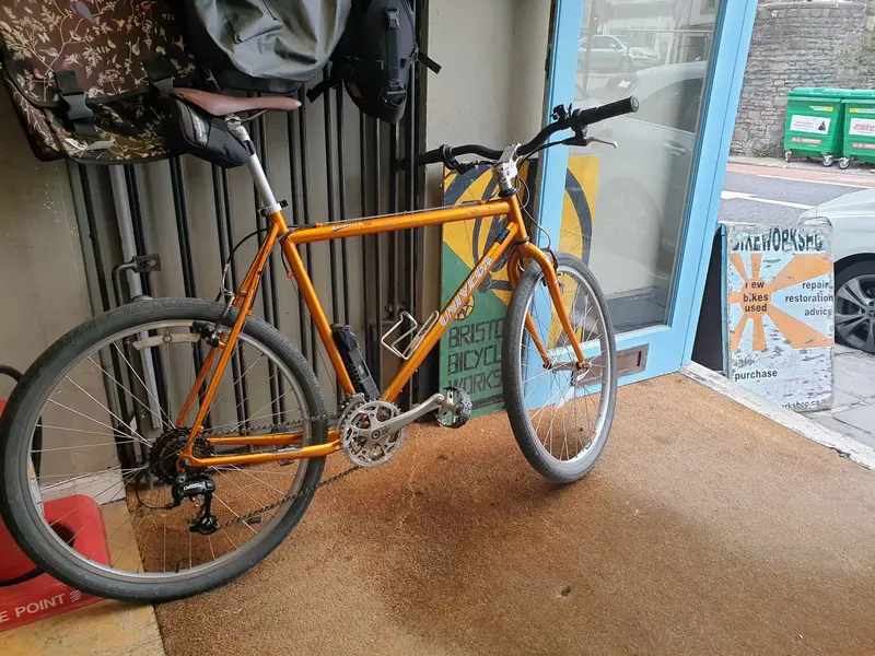

Some Retrobikes passing through Bikeworkshop in Bristol

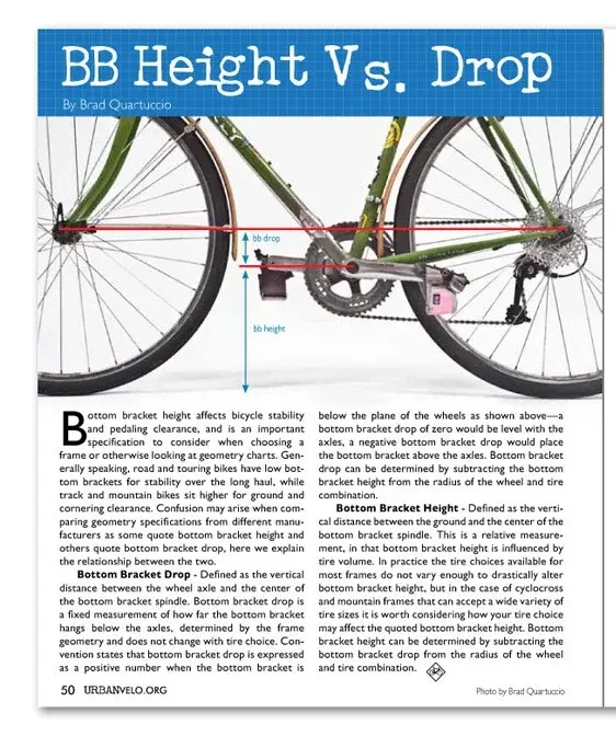

To my thinking, the number that defines frame handling more than bb height, is bb drop.
BB height can be changed with tire height, as you did by switching to 700, but the distance from axle level to bottom bracket will remain constant.
The bb drop has also been reduced by around 10mm as the fork is 20mm longer than the original p2
