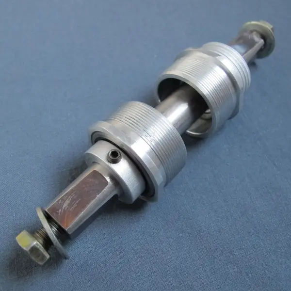

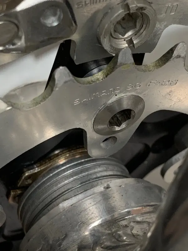

...and this is my CQP BB and M-2000 crank. The shims just set the chainline and everything is held in place by the locking ring.
any idea what length the inner ring bolts + spacers are? I have a set of m2000 cranks inbound and trying to get ahead of it with the necessary hardware.

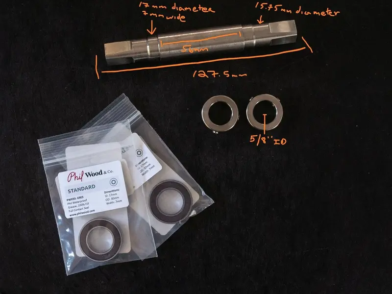

and to contribute - this is the BB I am putting together for my early, press fit, pre Grease Guard, Merlin
BB shell is 70mm wide with a 30mm diameter
bearings are ID 17mm, OD 30mm, and 7mm wide
127.5mm long spindle with a 56mm fatter bit in the middle. 56mm + (7mm*2) = 70mm which is the width of my bb shell. The bit just inside of the square tapers is 15.75mm diameter and ~10mm wide
collars are ID 5/8" which is 15.875mm. I am hoping that 1/10th of a mm is no problem. collars are ~8mm wide
phil bearings
ti spindle from ebay
ti collars from SRP
should work in theory, just have to figure out how to press it all together and into the shell. Will report back.
