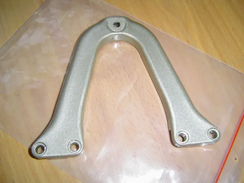

Rock shox?
Keep an eye out on here for the braces or even the forks themselves
Some aftermarket braces have enough clearance for 700c with a hole for a cable guide where a caliper could fit, just...
It would be a bit flexi!
Other forks had removable canti mounts, these can be fitted further up the fork. Pace springs to mind
