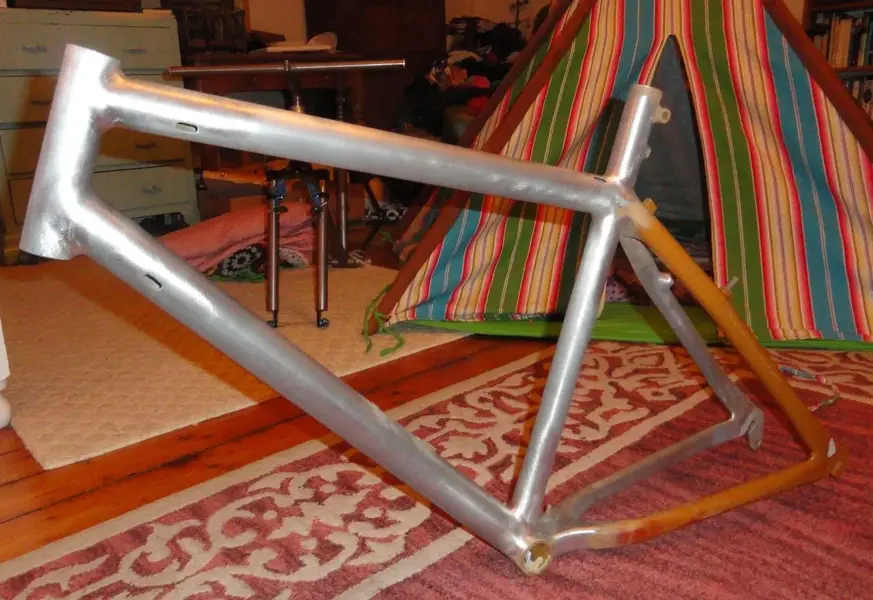

That 5mm thick powder coat is nearly gone now and a rather handsome old thing is starting to emerge. Since I stripped the inside of the headtube it has become even bigger.....I bought an ancient/tiny lathe a while ago and am scratching away at a lump of aluminium to create a set of 1" reducer cups. It should build up into a fine machine when it is all buffed up.
Having picked this up and started snooping eastwards I have discovered some real quality German gems which were total unknown to me previously. There is some really nice stuff over there if you dig deep.

Re: Seeking some german bike advise of the JUCHEM type
That's a thing of beauty indeed. And yes, there are some beautiful frames out there, and the engineering and geometry usually is top notch. There will always be at least one German bike in my stable.
I'm curious about the bit that sticks out at the back of the seat tube though. Is that the end of the split or is it a mounting hole for something?
The little tab is a complete mystery to me. It has a thread inside it so could take a light bracket perhaps. I initially thought it was for a hite rite but it is in the wrong direction. As the seat tube extension is so large it could be there to strengthen the area perhaps, the slot ends a cm or so further up.
Never one to hurry I finally started to pop this old girl together today. Not a glamour shot I know but you can see a little gem starting to emerge. When I can find a moment to get the last of the powder coat off and buff it up a little it is going to look great.
Theres a few nice hidden touches in there that make it stand out. Theres a Kleinesque sealed bb shell with no breath holes, bb's should last forever in there. The seat tube is made in a similar way to colombus slx with spirally cut internal butting, not something i've seen before on an aluminium tube set. The 130mm back end is set up to run a dishless wheel so it should be a tough old girl.
