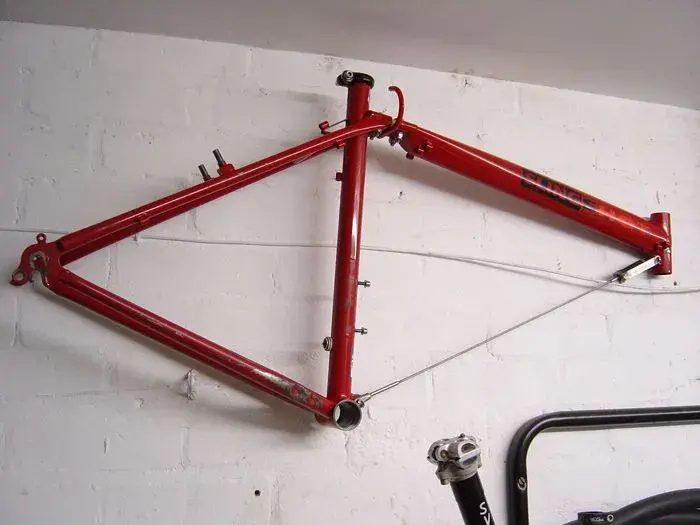

My Slingshot appeared yesterday - very nice it is too. Nicely made, pretty light and in good condition. Wont need a respray afterall.
I'm still stumped as to how it works....will make a great build just dont know what to build it with though...
It's kind of like a sweet spot (tm) URT frame with a really high pivot. If I remember correctly, the "spring " is a combination of the spring in the wire (downtube substitute) at the head tube end of the wire and the polymer "hinge" (rumoured to be the same material as some part of an F-15). The damping is from the polymer.
So, in summary, it works like an elastomer sprung/damped high-pivot URT frame.

Ohh, and remember Jez...the Slingshot IS NOT a suspension design.
It is an energy capture and return design, taking the wasted lateral movement of the bottom bracket that is not used to propel the cranks forward, storing the energy in the spring by compression, and then returning the "forward" energy during the weak phase of the pedal stroke by uncompressing.
If you were to look at the process in slow motion, the bike frame would "inch worm" in the vertical plane.
It's not about comfort, it is all about SPEED.
cheers,
rody
Wow - thank you Rody - awesome advice there!
I wont get it resprayed - its in pretty good condition really - apart from teh missing paint which I can touch up.
Understand a little more about the way it works- I have a nice rigid I can use (an odd crown mated with some Syncros steel legs). Should work ok.
This will go xc pro methinks as thats all i have sitting here.
