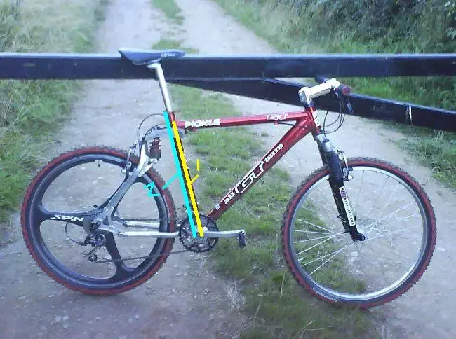

So, my old LTS was an 18" frame. Line 1 = 18" and Line 2 = 20".

Thanks for the detailed responses. I should have posted a pic earlier, but here it is. As the top tube meets the seat post above the pivot, can I presume this is a 20"?
That look's like it'll be an 18" like Pickles red one above, my explanation was slightly wrong, the top tube being under the pivot on a 16" was right but the 18" has the top tube above the pivot.
I cant remember seeing a 20" LTS, like you say they are big for their size so a 20" would be huge, maybe due to the LTS having a higher bottom bracket height.
Not seen an LTS with the pivot behind the seatpost. Must be a huge frame!! Which model is that frame Mark S? IS that seat post skinny enough for steel?

Looks like an LTS DS to me, the one with the curved seat tube from 1998.

Yes, like this:
Should be measure much in the same manor, utilising an imaginary straight line up from the BB to top tube.
