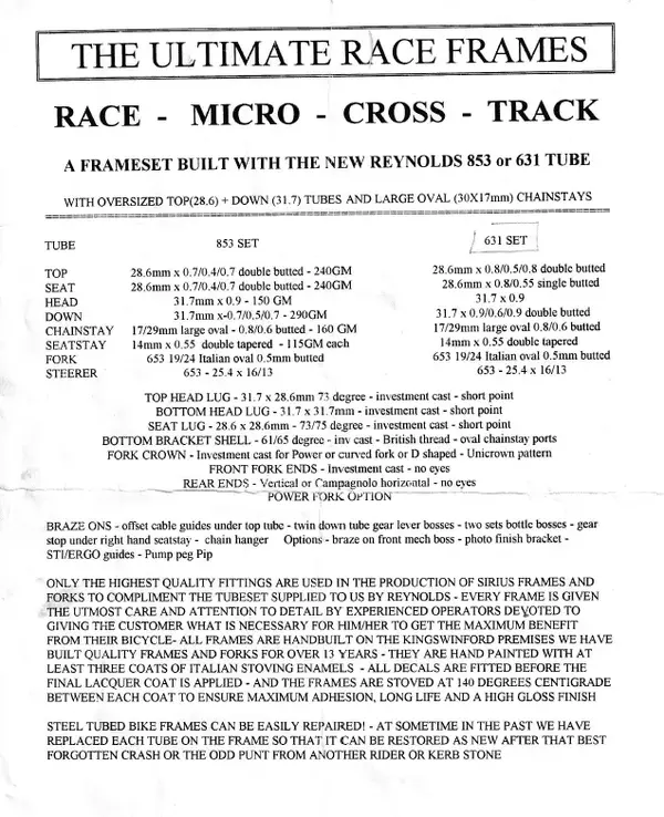

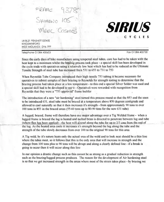

This info might help as i bought one in 1997 ..and just completely rebuilt it !
