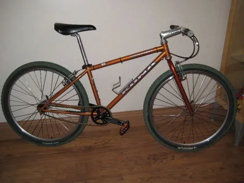

Done !
Here is it , just this second completed, I went for a 36 18 setup which feels spot on, I need a Chain tensioner though as the chain is too sloppy :cry: Can anyone advise of a good one that will fit.
Cheers

single speed
Chain tensioners suck-if you can adjust your gears to keep it tight you would be better off. Your 36-18 is a 2 to 1 ratio- if you used perhaps a 38 tooth chainring in front and / or a 19 cog in back it might just tighten up enough to ride just fine and with a 38-18 you only raise your gear ratio about 5 percent, and a 38-19 is the exact same 2 to 1 ratio you seem to prefer.
Try a half link chain on your existing gear set up, it will allow you to fine tune the tension. Or just fit a couple of half links into your existing chain.
Halflinks are available in both chain sizes.
2 jockey wheel tensioners are the best, if using an old deralier its best to use a short cage type such as a road bike mech as it has much less lateral flex.
