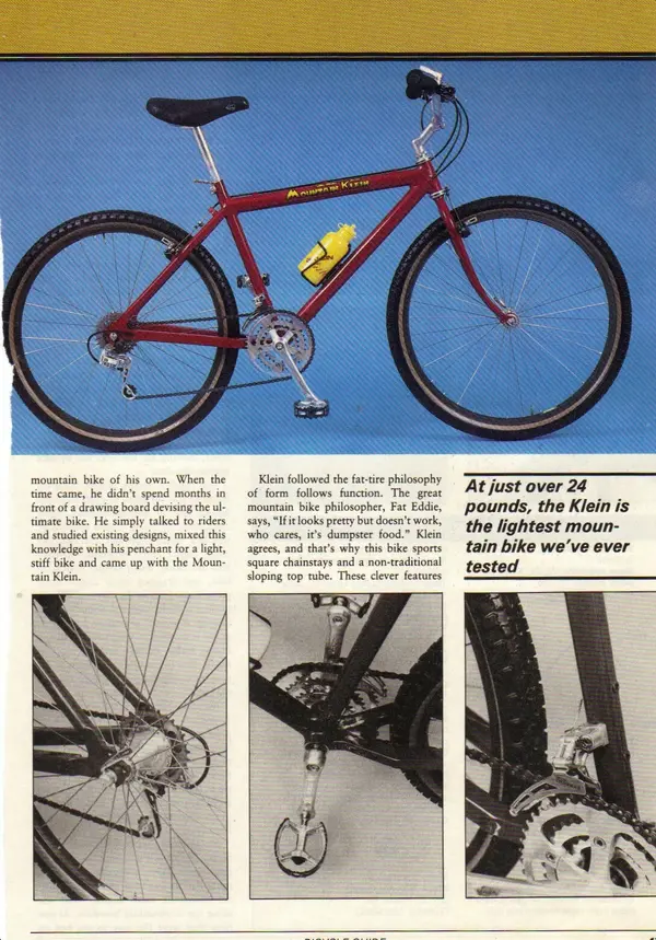

Not sure what mag or what year so not quite as helpful as it could be 🤦‍♂️
But spec references 27.4
Also references Shimano XT throughout the review which could suggest 87, but most of the pics show Deerhead so tough to pinpoint it.
