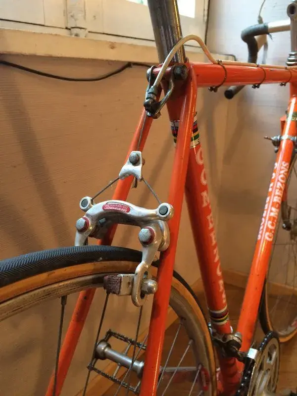

Centre-Pull seem to have a reputation for being the better braking system for bikes, hence, even, many direct pull brakes seem to be a variant of centre-pulls that are on a lot of modern Mountain Bikes. The thing with centre-pulls is one needs to get a brake hanger as well. That shouldn't be a big obstacle in obtaining though again, if one wants it period-correct, that does cross the mind as well.
Side-pulls seem to be more convenient to install and can work very well as well, if one is going through a lot of rainy or snowy weather, perhaps centre is better.
