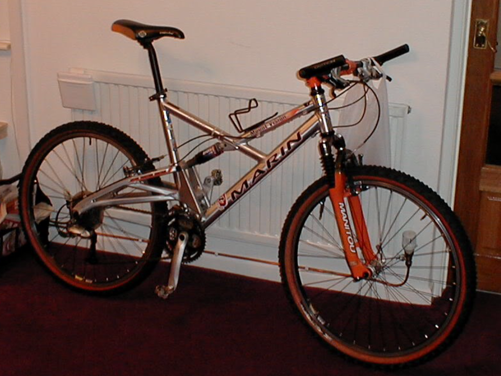

My 2000 Marin (UK spec*) Mount Vision. Pictured here in 2002 about 5 mins before its new owner collected it. It had only been ridden about 120 miles, was returned to totally standard spec when sold - broke my heart to sell it but I needed £500 to pay the deposit for my mortgage that week and no other way to raise funds! I replaced this with a 2005 Marin Wolf Ridge which I'll take pics of over the weekend when I dig it out (almost quite literally!) from the heap of boxes and stuff in the garage!
*IIRC in 2000 the Marin USA and UK spec models which had same names and same basic groupsets, differed quite a bit in other specs and colours. This is the uglier colour scheme of the two Mount Visions that year. The USA spec was silver and red and much better looking! 8)
