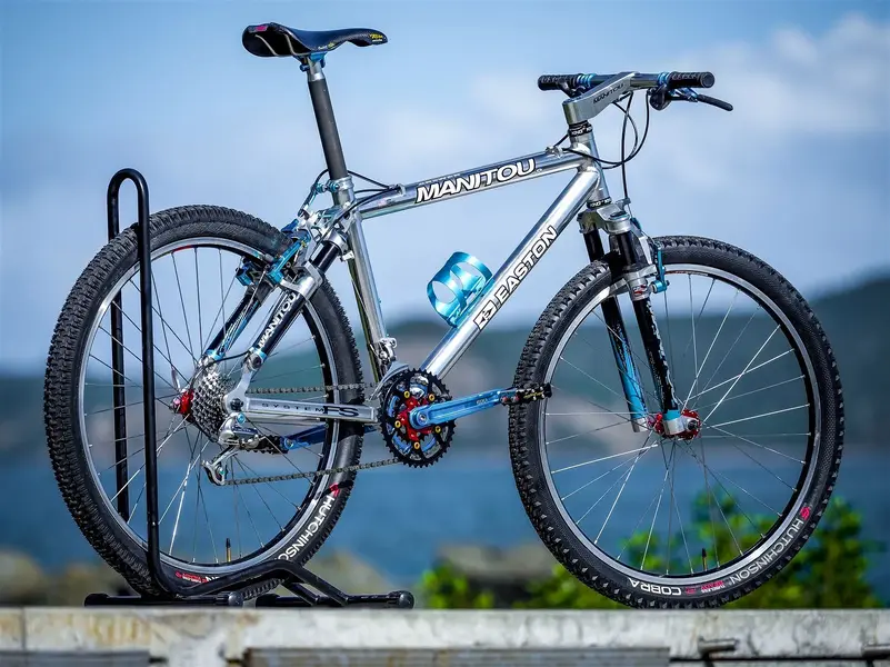

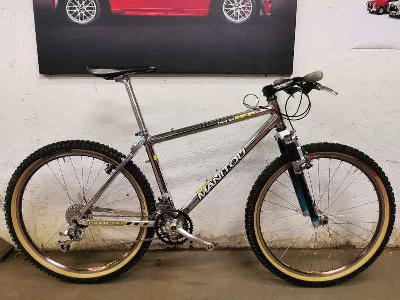

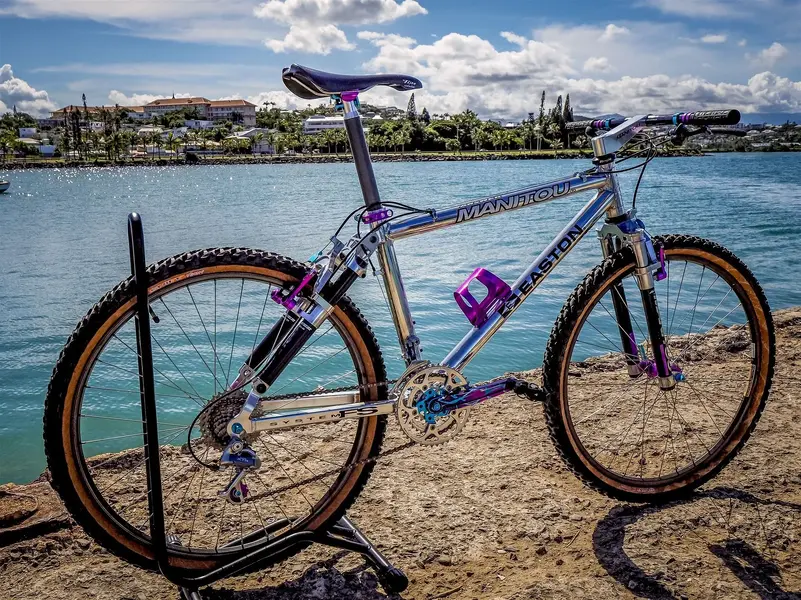

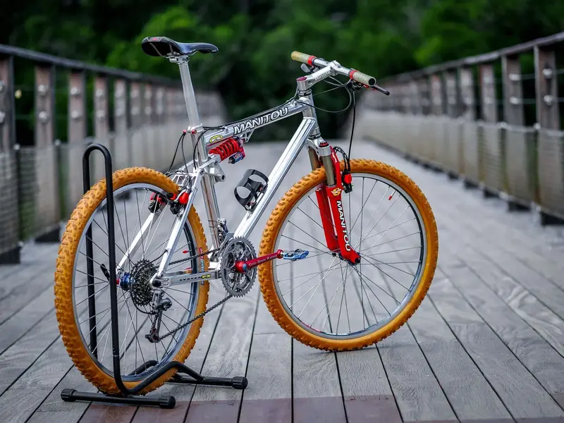

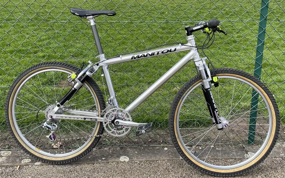

I've seen a lot of Manitou in commercial version equipped differently 🙄...I found it very interesting to see these renderings and the choices of each. But where are these bikes?'? 😅
