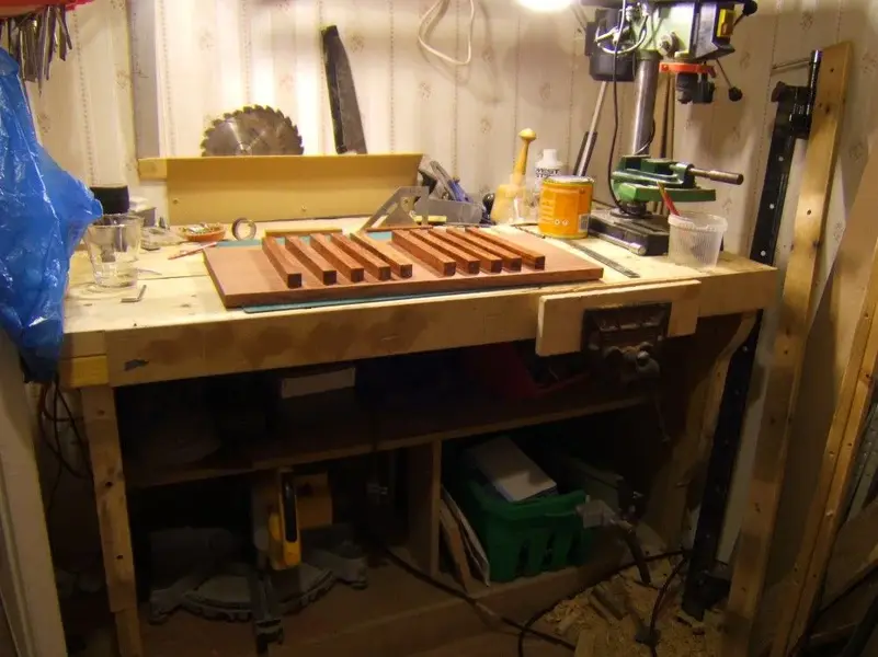

Mine here is 44mm thick top made from standard cheapo pine, with the front overhang(need an overhang to get clamps and the like onto) of 8" being another 44mm plank screwed on to thicken it and add a bit of support and less bounce, when bashing into things with hammers and the like.
So you could add a flat plank or some strips of 18mm mfd glued together and placed under :?
TBH I'd never had the time to construct a proper bench. I'd love to spend some time making one, given the big cabinetmakers benches can be £2000 to buy.
Front view and camera turned around to the rest of the pigsty :lol:

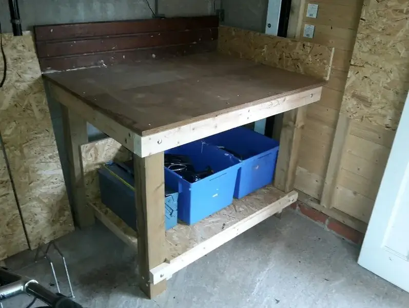

So here's my bench what I done build. Seems piddly compared to some of these impressive erections. Size was dictated by the timber I had available and minimising waste from what I had to buy, plus I don't have unlimited space (too many bikes). But it's a tidy job if I do say so myself. Not even got as far as moving the vice on yet but powered up this weekend which is a step in the right direction.
