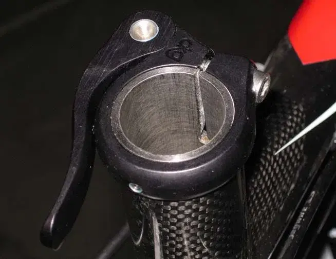

Most all new bikes use a separate seatpost clamp, your 575 included, but this should not pose a problem. You'll need to get a clamp designed for a 6mm skewer or modify yours. The trick is to secure the clamp to the frame.
In the photo you'll see a small screw opposite the slot (BTW, this is not actually a clamp with 6mm skewer hole). That is a #6-32tpi x 3/16"-long dog-point set screw. Drill the clamp opposite the slot with a #36 drill (7/64" might suffice) and tap it with a 6-32 tap. Slip the clamp onto the seat tube. Screw in the set screw (or grind another 6-32 to a point) to mark the seat tube. Remove clamp to reveal where to drill. Drill with 3/32" drill. Assemble.
Oh, and yes, you might need an oversize ring clamp if your seatpost is over Ø27.2mm. I've got those in two sizes: Ø28.2 to 30.0mm and Ø30.2mm to 32.0mm.

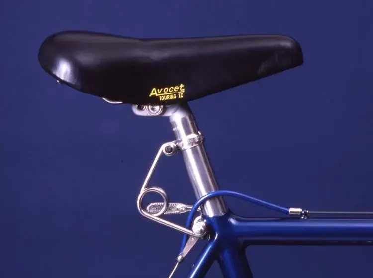

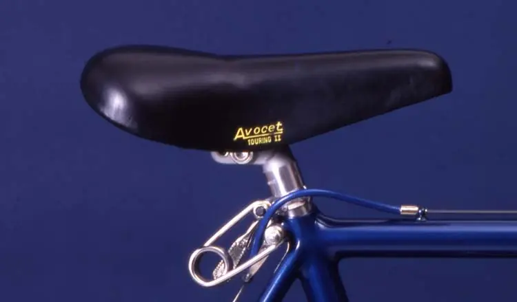

Deveron got me looking through the archives for Hite-Rite images. I found these from a Mush Emmons photo shoot at the Industrial Building Center in Sausalito. This is a 1983 Breezer Series 2. Most all were nickel plated. This one is chrome plated, then painted by Bernie Mikkelsen.
First, the Hite-Rite photos. Josh Angell and I came up with the idea in 1982. This one is an early version with a clamp I made from aluminum bar stock. Later clamps were of die-stamped stainless. The brake housing should really be on the other side of the post.
-Joe

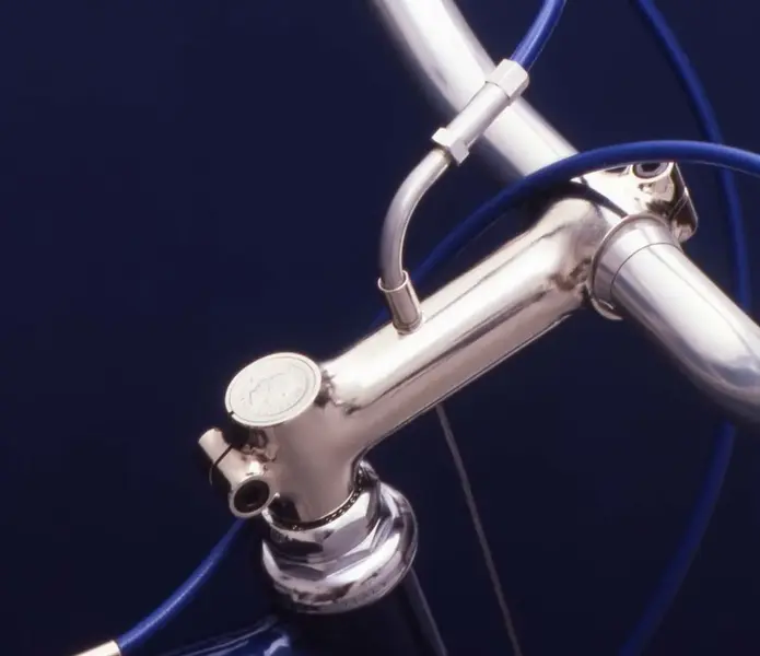

1983 Breezer Series 2. BTW, the difference between S1 and S2 is only that the Head tube and seat tube collars are visible on S1. S2 HTs are oversize and bored out for most of the middle, like most good BBs.
Oh, and on Series 2 frames I also made the stem. I sweated a stub into the steerer for a very direct connection. I then silvered a Swiss 10 centime coin in the top of the steerer tube.
