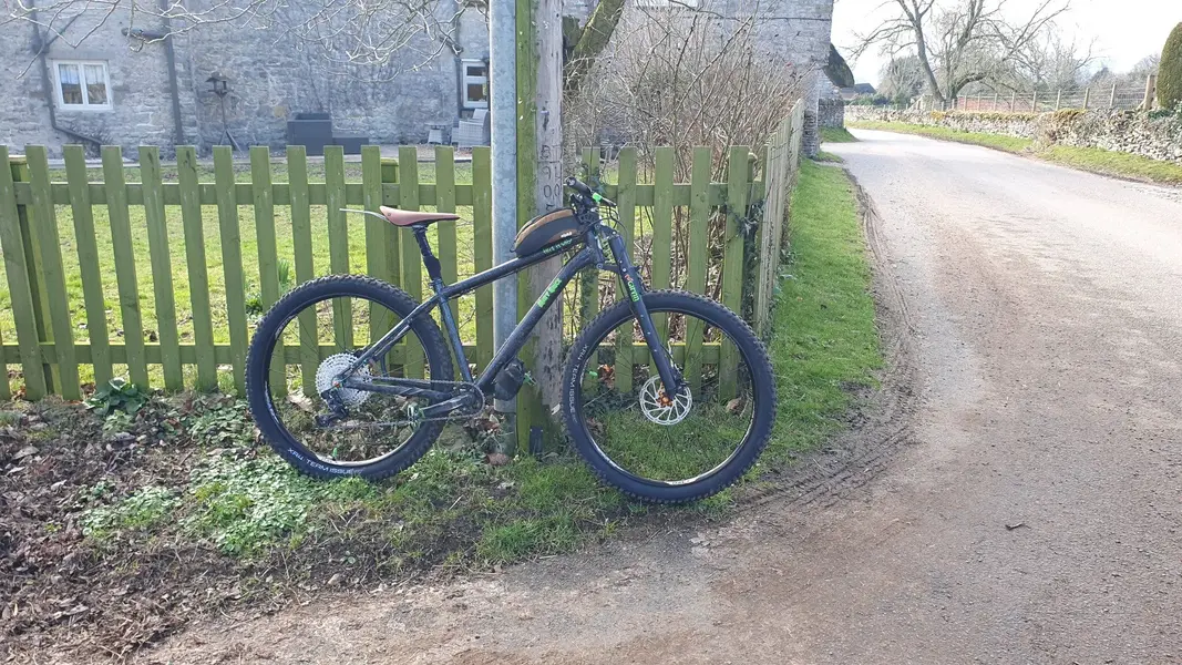

29+ Wheels arrived yesterday, thanks Slam69 for the great service. Built up last night so I could have a little ride this morning whilst on Dad Taxi duty. Much faster rolling and will be great for UK Spring/Summer trips....And no more accusations of the Zombie Apocalypse 🤣 20230304_105829.webp
29+ Wheels arrived yesterday, thanks Slam69 for the great service. Built up last night so I could have a little ride this morning whilst on Dad Taxi duty. Much faster rolling and will be great for UK Spring/Summer trips....And no more accusations of the Zombie Apocalypse 🤣View attachment 716142

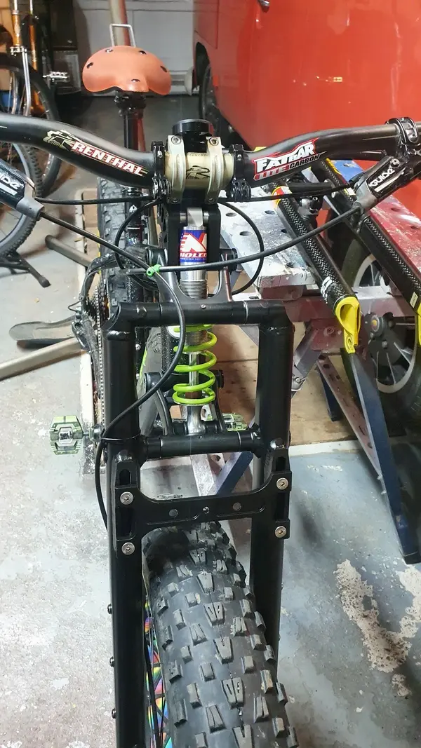

How many people are confused by your fork?
Any chance of some shots of the brake mount as its rare to see one welded and even rarer to see one on the right side (not to mention widened).
Absolutely amazing, completely in love with that!
And the thing is...it's not for show..it really does work how I wanted it to. The NR1 shock needed a complete overhaul but that has made a real difference to how it works. It's really easy to adjust preload depending how loaded up the front end is and I had at almost fully locked out in Norway when riding on collapsing crust. Dan really did an amazing job and his attention to detail and loading mean I feel confident using it in any situation
stunningly done. did he add any strengthening to the legs, they were known for being thin in sections. I like the welded on "spacers" rather than just spacers, looks far neater.
very nice, a fork I've tried to get my hands back on to for years but unlikely to happen now as the prices slowly climb.
I asked Dan Chambers to build them for me as wanted suspension forks with fork cage mounts and I thought Girvins would suit Fat Biking/ Bikepacking really well . I love the simplicity of the shock and they work really wellView attachment 716158View attachment 716159
Dan made new legs with slightly thicker walled alloy, and welding the top mounts and dropouts from the original legs.
Keep looking out for the Forks. I didn't pay much for mine as they were very rough which suited my purpouse
