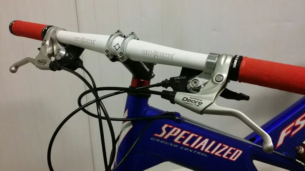

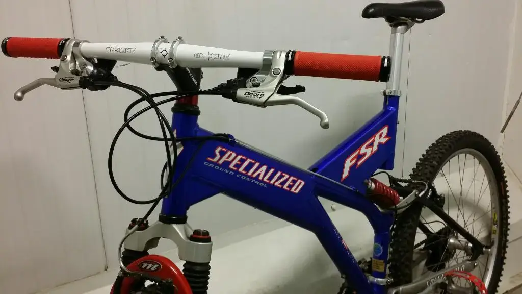

Well after deciding I liked mine too much to sell I spent some money tarting up the front end. Grips bars stem and red stackers courtesy of planet x all for the princely sum of 24 quid 8)

Re: Re:
Tart ;)
