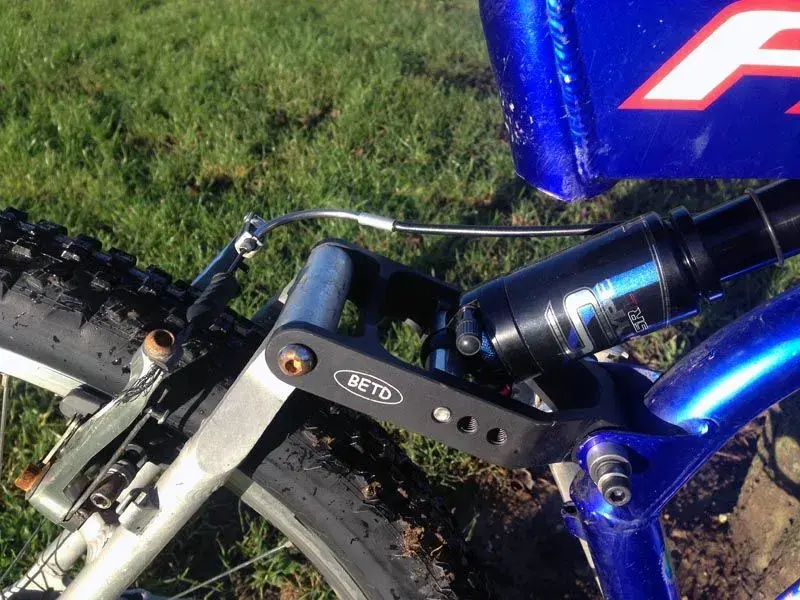

I have tried out the extended BETD mount off my old ('99) FSR elite on the Max Backbone (frame size: L) & found that it just pushed the seatpost waay too high to be comfortable, even on the lower of the two holes, as the pivot mounts are longer than the standard shock link. I've got my configured as an AM/XC-type bike anyway, so the regular travel link suits well (running an X-Fusion O2 air shock, 165mm e2e) with Magura Durin MD120mm forks up front.

Yeah, I tried the same.. Swapped my BETD link off my old 'regular' FSR and put the factory link on & it just felt rubbish! But then again the BETD link screwed up the BB height & shock position on the Max Backbone - so just goes to show BETD know what they are doing! :wink: I'd go with stock first, then start playing around, the linkages are so easy to swap it's not a big hassle anyhow.

So you say the BETD link worked pretty good on your (mine is a 1998 ground control, the blue one) regular FSR? That might be something I could try. :idea:

Yeah, my BETD link was the old 2-position one from around '99. Yeah, gave incredibly plush travel on mine - which was a Black '98 - so should work well!

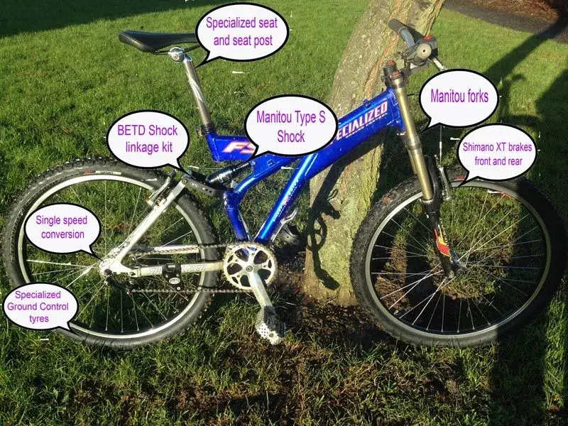

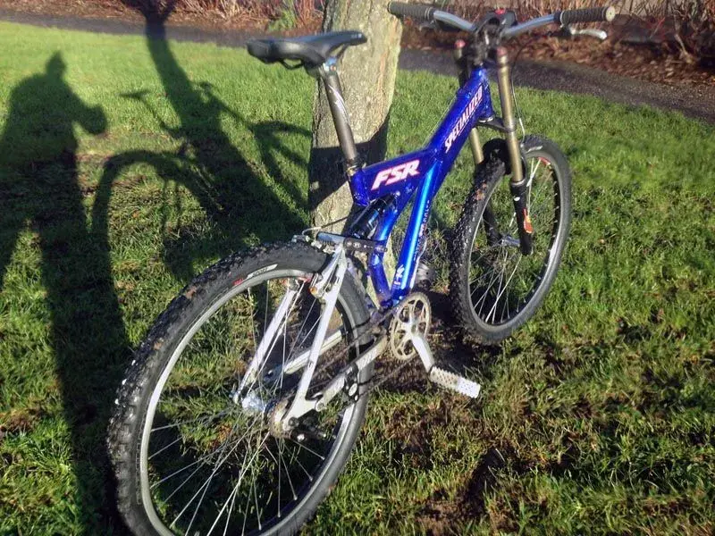

A few upgrades to mine this year, all done and rolling again. Very happy.
i'll think about a frame and form respray in the spring, but we'll see.

Osella":3jdh9uwf said:
Wow - that's excellent news about the seatstays! Might have to keep an eye out for a 2001 Enduro back-end for mine then! Better than the A2Z adapters..
That Enduro's looking very nice too!! Very understated..
Hmm, sounds like a plan for the forks.. Mine are 80-120mm, but the adjustment happens at the bottom end rather than the top (if you understand) so they are still the same A2C!.. Yeah, short stems are a must!
