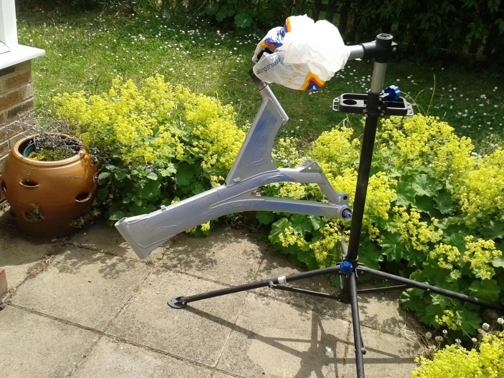

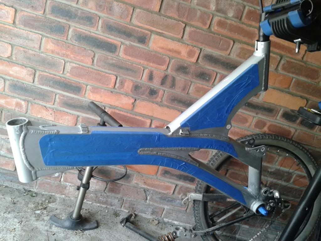

So i attempted to mask off the original decals and paint around them, i have painted a fair amount of stuff now, motorbikes, cars, pushbikes, i know that masking off the decals is never going to look quite as good, but i have a little plan, basically i will dust a coat on everything to keep it one shade of paint, and only use thicker coats on the parts that have been sanded back to bare metal/primer.
Paint applied.
masking tape removed while paint still wet to prevent any edge buildup/lines/problems.

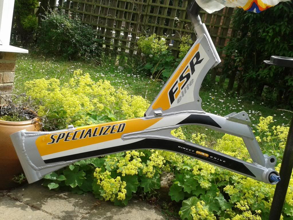

Silver elite has a kind of anodised finish to it, really quite nice, for this paintjob i simply used silver Hammerite, gives the same kind of bobbled/anodised finish, and the colour match is pretty good, i also had half an unused can in my man-cave as i use this stuff to spray alloy wheels (pretty durable imo)
Total cost = £0 :) the decals have a little over spray on them near the edges in parts, this will come off when the paint is hardened properly and buffed up.
The bike is now back together, everything was greased up and i added clear selotape to cable rub areas (pretty much invisible) and anti rattle cloth tape to any cable that will touch the paintwork, did 13 miles on it this morning and it is silent. :D
Bike now looks fantastic :)
