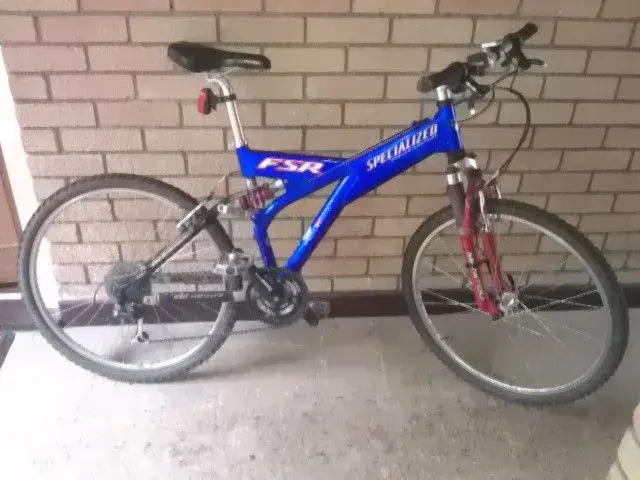

Newly acquired fsr any ideas on some better forks and rear shock..?

Fast bumpy forest paths and tracks, dirt and gravel. Don't like the standard manitous there crap, and rear shock doesn't do much got to have a play :D

Sounds like mostly XC stuff? I'd go with an air sprung fork with around 100mm of travel and a rear air shock. Rear shock size is 165mm by 55mm in case you were wondering. Personally I like fox float shocks and forks, but a friend of mine swears by his rock shox reba. I have a 130mm fox float r fork on mine and I've been looking for a fox float rear, but have been holding off for a new link since I like a little more travel. Also upgrading your headset with the fork will help :)
