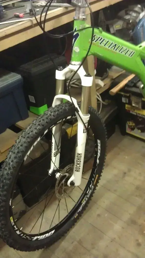

Yeah I did, have been looking for ages n didn't want to pay £120+ getting it over from US...therapy components....my mate also has one on his fsr n he did chuckle saying he'd paid £25 for his back in the day.....we be drilling the frame next week n the rear disc to sort.
The company in the US holds the patent for the design of the fitting now....so no cheaper copies it would seem....pricey for a piece of alloy but in the end I will be chuffed with the out come n done .....well till a new paint job!
Either way it's gonna b good to get out n have a good thrashing for the spring!

Fair enough...it just seems mental when they were so cheap to buy. But I guess if you need it, there's not much you can do.
The are neatest solution too...I hate the old Hope torsion arm, it's a monstrosity. I hated it when they first made it, and I still hate it!
i prefer modern forks on these frames. have some Manitou double crowns, but not as plush as my Zoochie Marathons :)
they'll be going back on in the near future :)
i'll actually be splitting my FSR groupset very shortly :( (keeping the frame though!)
I do have the original judy xl double crown forks but they r spares or repairs if anyone's interested? Pm me.
Thought about double crown again but thought hey, go with something new...so close, so close......
