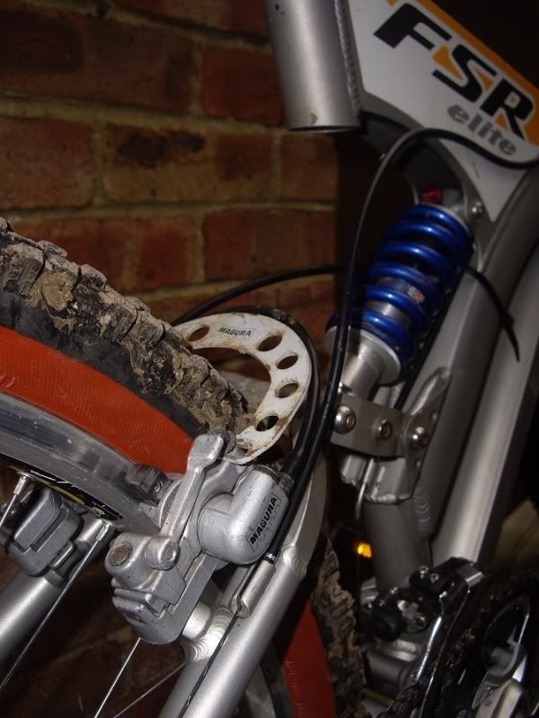

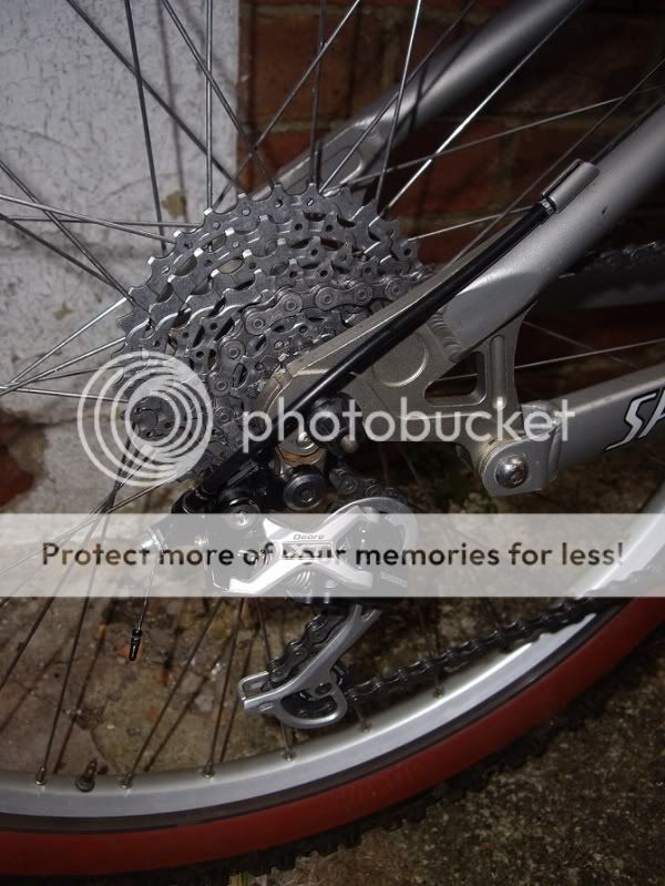

a short question: could you all be so kind to take a picture of your bike's right back?
So we all could see how your cable is routed from pivot to the rear derailleur?
many thanks!
here you go: from my build thread images - but you can clearly see the cable route right up to the rear mech :)
since sorting my cassette out, i've not had a GS problem at all.
all my problems are centred around the shock :roll:
Ah, you have a shadow RD. Different (and functionally better) stuff :)
Thanks anyways, if my problems continue I'll try a shadow RD, too.
yeah, that could be the solution to your problems :) M770 groupset is quite nice :) (so far) :P although i think the non drive side BB bearing is starting to make some rumbling noises/vibrations! :S
