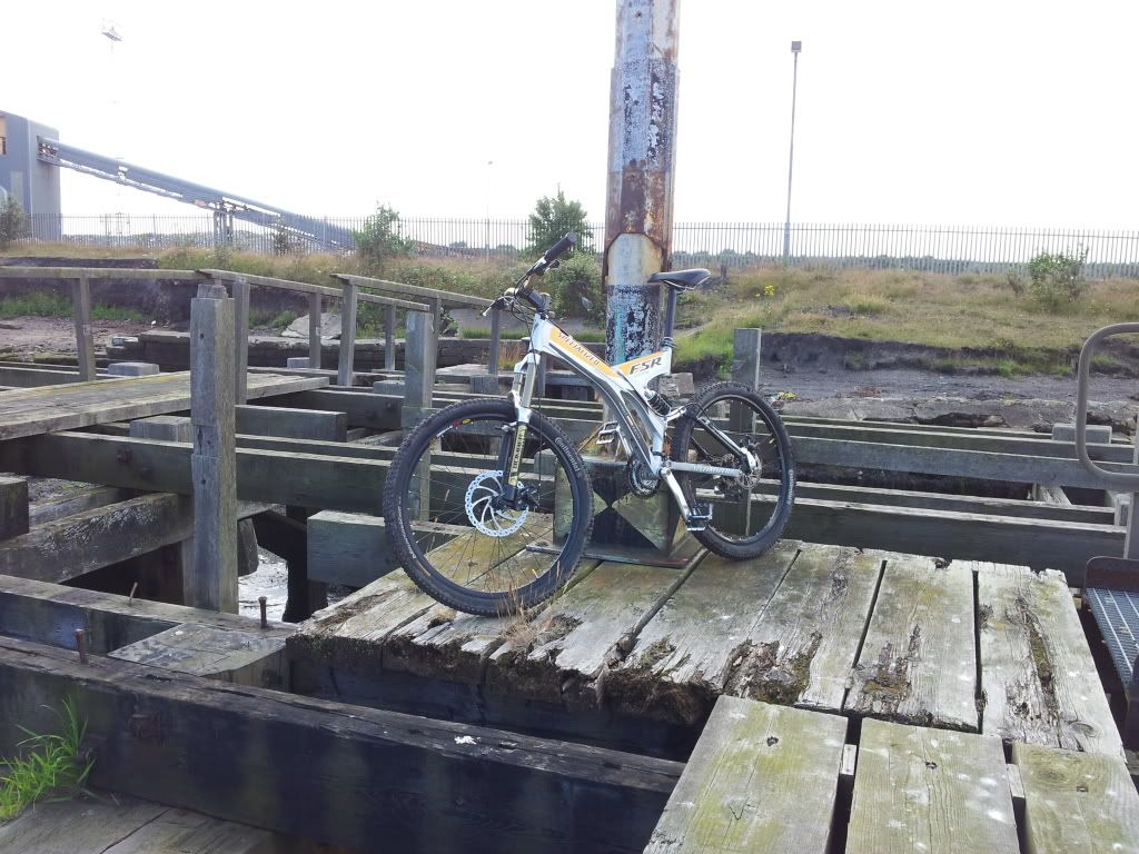

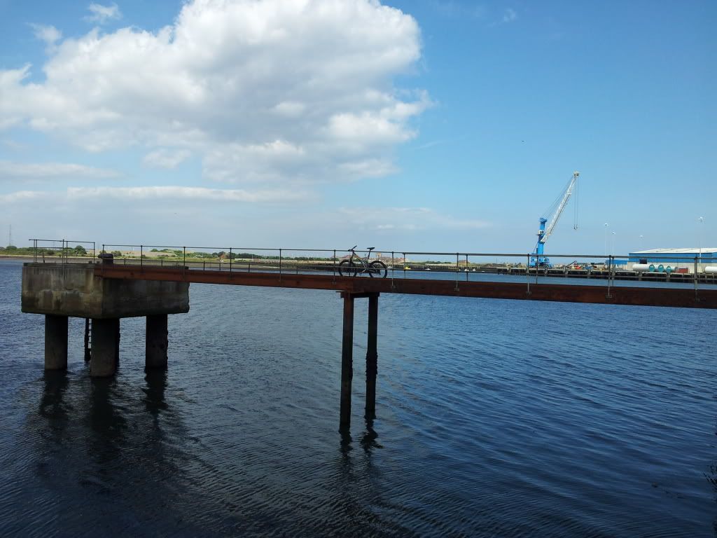

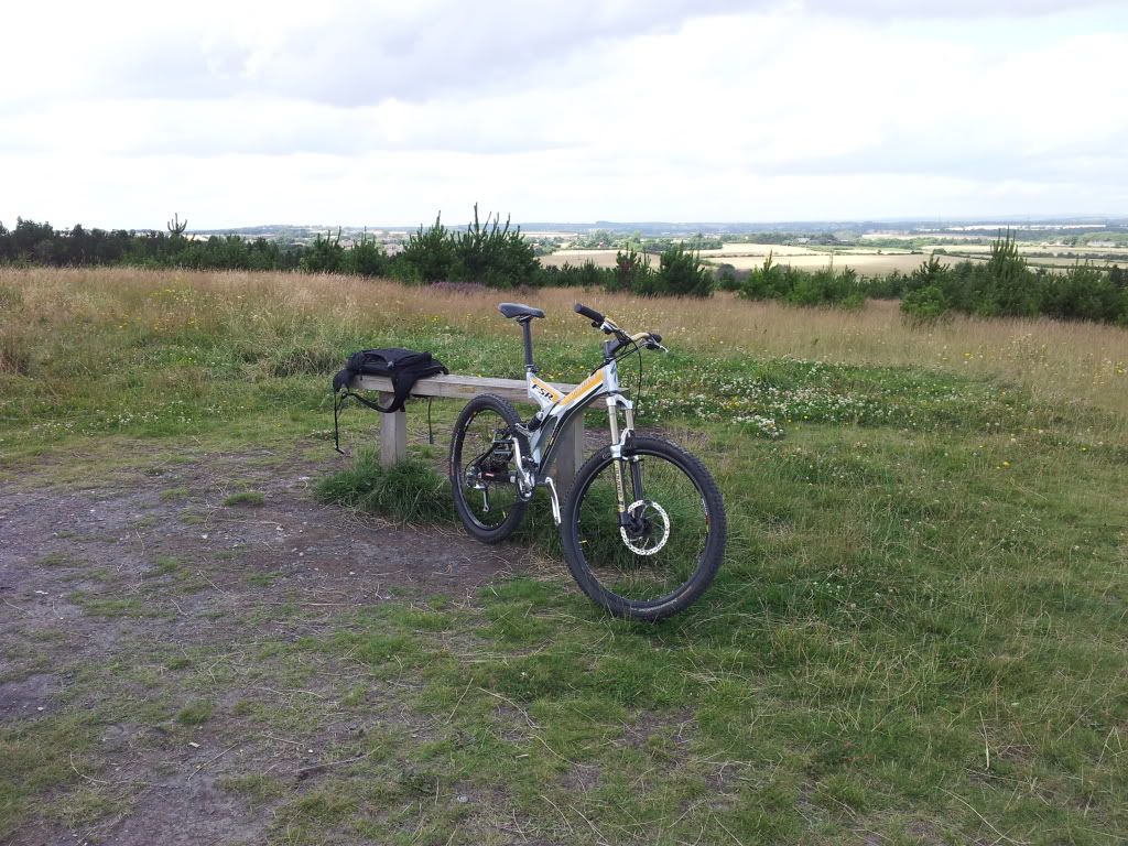

Went out for a 40miler today to check out a new spot that is earmarked to have some funding spent on it and maybe become a new trail center.
Some pics of the Elite Max while i was out :)

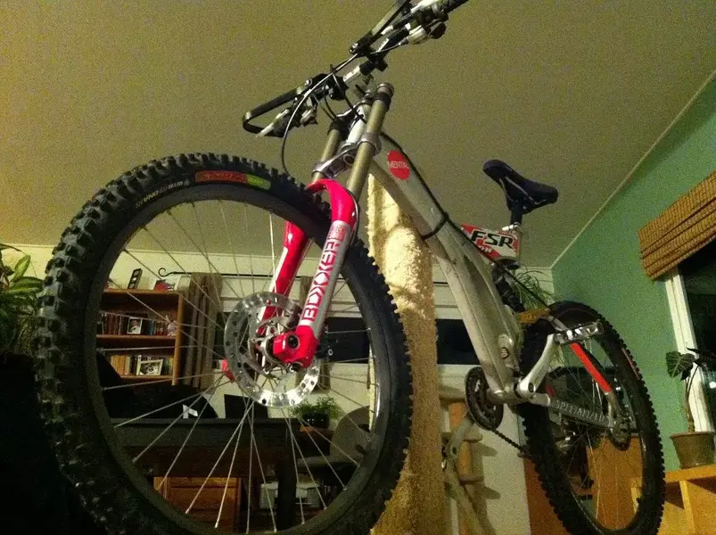

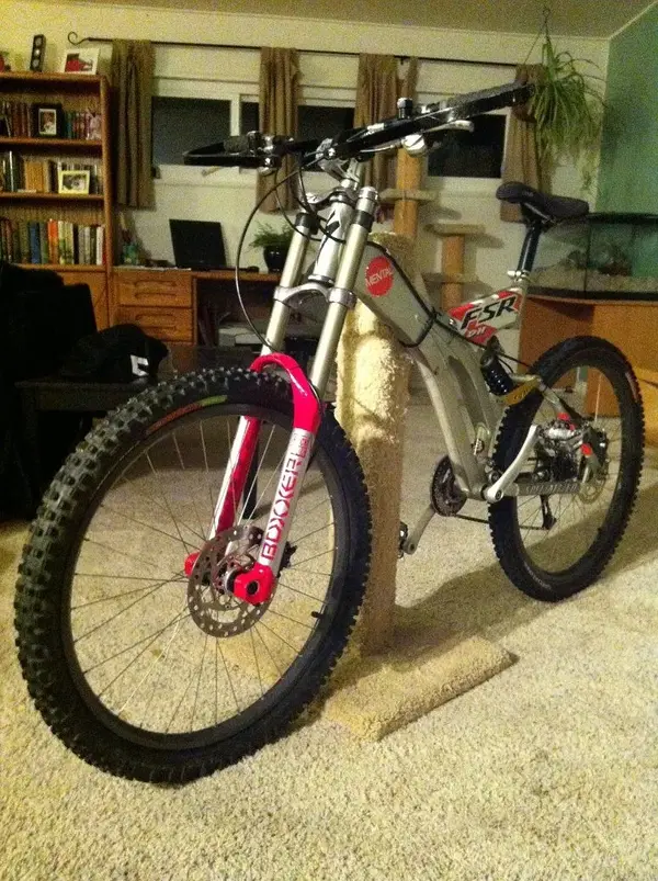

My old Boxxer Pros were cracked. Luckily I knew someone that's been holding onto a brand new pair of Boxxer lowers that fit the bill with minor changes. Looks freakin' awesome! Going to a little light trial riding tommorow and then 17 miles of down hill riding next weekend at Downieville!
