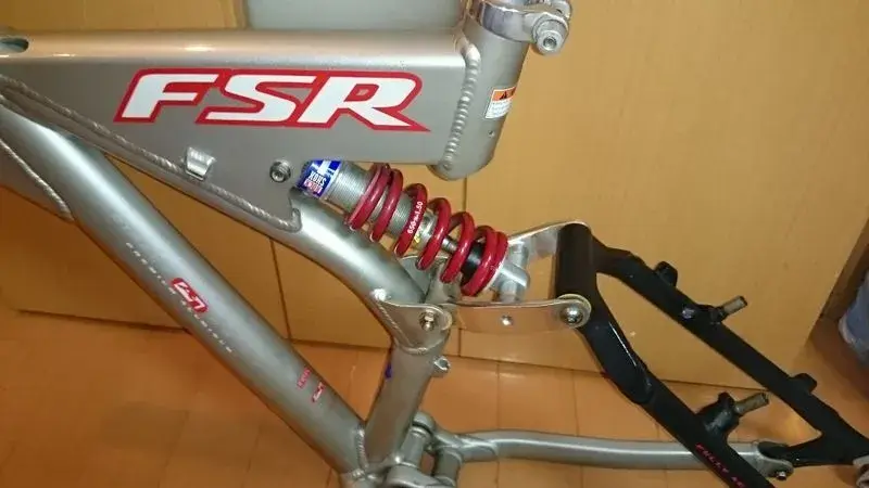

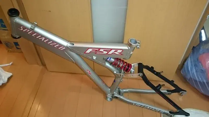

Anyway another pic, this is the same bike that was built up at my lbs for years that was shown earlier in the thread. Went in today and it was nowhere to be seen and my heart sank but he had stripped it down to frame and Showa forks and had it on the wall next to 3 new early 2000 Spesh frames. OK says I "sold" and it was, the Monsters too. He actually said to me 3 times are you really sure you want to buy all this! I'm fairly sure this frame is a '98 but anyone who can say for sure let me know.
Take a look at these Showa double crowns, rare as hell. Dust seals are cracked but so far they still hold air and oil. Very tempted to keep them, we'll see how much the nos Monsters go for. Today was a good day.

Do I take it from that pic with the coil over shock, that I could simply replace my knackered air shock with a coil over as long as the eye to eye was the same, or isn't it that simple....??
In principal yes. Although I had to invert mine and add a gonzo valve as the linkage obviously wasn't designed with air shocks in mind! Eye to eye, aye! 165mm will see to it :)

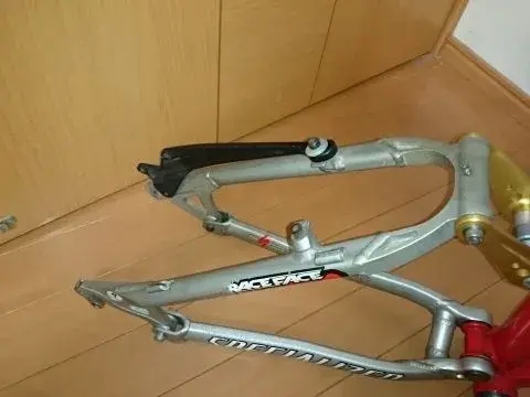

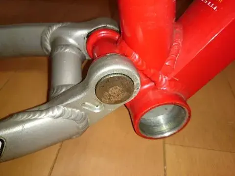

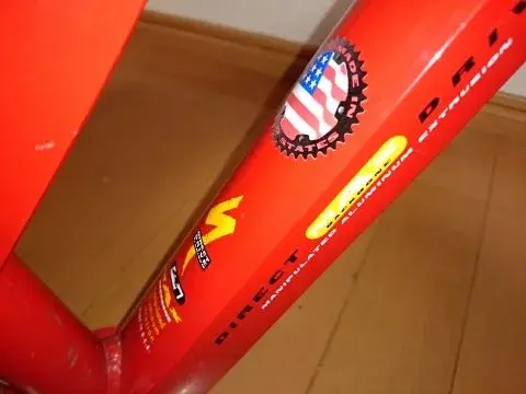

Wasn't really satisfied with the new FSR as it was an older style with no bearing just bushes. Unsatisafactory. So a few weeks trawling the local auctions saw this land on my doorstep.
Max backbone with full needle bearing upgrade and a shark fin. Boom! Satisfactory. And it's a medium not a small as the seller said. I will update Twain's FSR bearing thread later but I have a feeling this is all bespoke. I do love me a well-modded FSR.

quest que cest le linkage?
that doesnt look like any linkage Risse/BETD have done before....???
any markings on it?
EDIT: that linkage looks to be an original FSR DH linkage - lots of forum threads showing up images that look to be a stock component that came with the 99 FSR DH model....might be more to look into that! cracking find if so!
