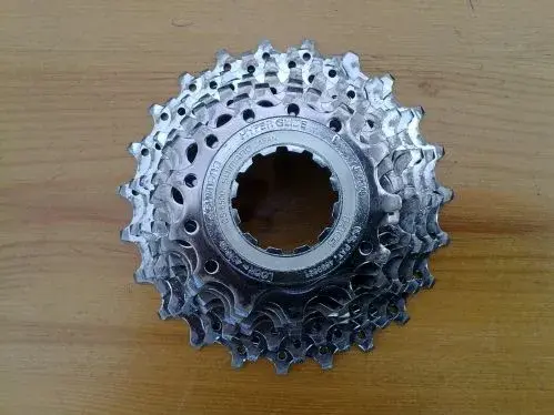

Shimano Ultegra CS-6500 Hyperglide 8-Speed Cassette 13-23
In Very Good Condition
Minimum Wear
Price inc postage
£18
cassette
The threaded lockring is a cs-6500 (9 Speed)
But the main cassette is an 8-speed.so the outer ring is not original
This was recently removed from an 8-speed wheel
Hope this clears it up
Still looks wrong to me....
That type of metal plating came in on 9 speed.
Unless it is a 9 speed cassette respaced to 8-speed.
Correct cassette for 8-speed Ultegra was HG70/1 and HG90/1 which weren't drilled out. Dura-ace 8.speed cassette had matt surface and wasn't drilled out either.
If top 3 sprockets have spider, they are 9-speed.
