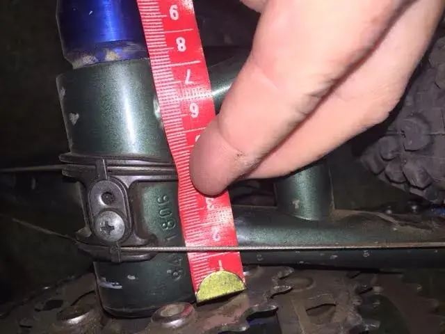

Took a picture of the bottom of the frame, excuse the crude measuring tape. But the width is looking like 73mm, although the bottom bracket seems recessed inside slightly so is it really 68?
Your measuring tape is starting on the drive side cup, not the edge of the BB, which is some 3-4mm further inboard. I believe you've got a 68 there (the crude measurement seems to be about 69-70mm by my eye).
